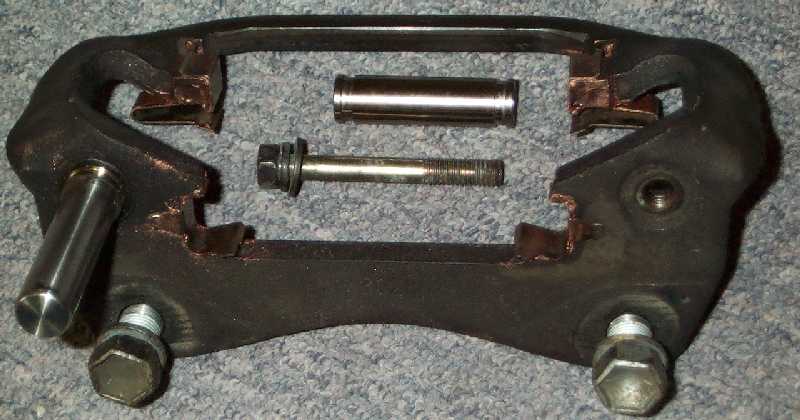

I tried to replace the rear brake disc and pads on my car today and I couldn't get the two bolts off that hold the part of the caliper where the pads slide in. As I understand it there are three bolts that need to be removed, the 12mm which lets the caliper slide up and then the two bigger bolts to get the whole caliper off the disc.
Is it a 17mm? I tried to fit a 16 mm which was too small and an 18 mm which was too large. Do I even need to take this part off? The outer brake pad was easy to remove, it is just the inner brake pad that wont come off so I thought I need to remove the rest of the parts too?
This is what I am talking about: http://www.mr2turbo.info/pics/cropped/1 ... eplate.jpg

You won't be able to get the discs off with out removing the caliper bracket, and they are 17's yes. They can be right pain to get off. Impact tools are your friend if you have them. If not, patience, heat, and WD 40 usually work.
Breaker bars to crack them off will work if you have the room. There's also the poor man's breaker bar, ratchet with a long collar socket and extension bar on the end, or the poor mans impact wrench, a ring spanner on the bolt and a hammer to knock it free, or a centre punch on the edge of the nut. All are health and safety nightmares but do work.
Try not to chew them up, as the are hardened steel and are xxxxxx to cut through (Ask me how I know)
