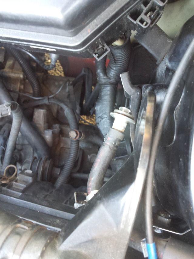

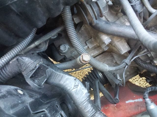

I removed the charcoal filter and looped the hoses but not sure if ive done it right.

You want to join those 2 hoses you have bolts in.
Find a length of hose and join them.

The top hose I believe is the vac line to the tank, the tank needs to breath, by blocking you are going to create more and more pressure in the tank, to the point you may not be able to open the fuel cap!
The bottom hose goes to atmos from what the canister releases.
So by joining you are relieving pressure in the tank and it's being released via the bottom pipe.
