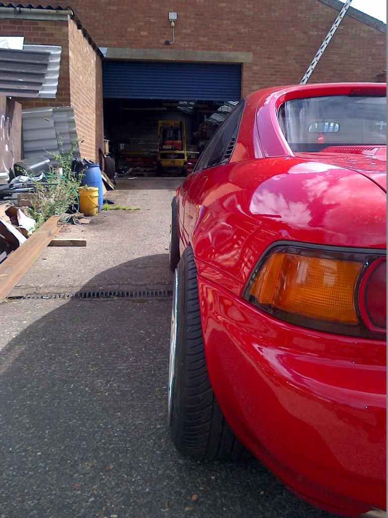

I run 9J et12 front and 11J et10 rear on my project MR2

Haven't got any good pics as I'm at work atm, but here's one before the arch work :lol:
