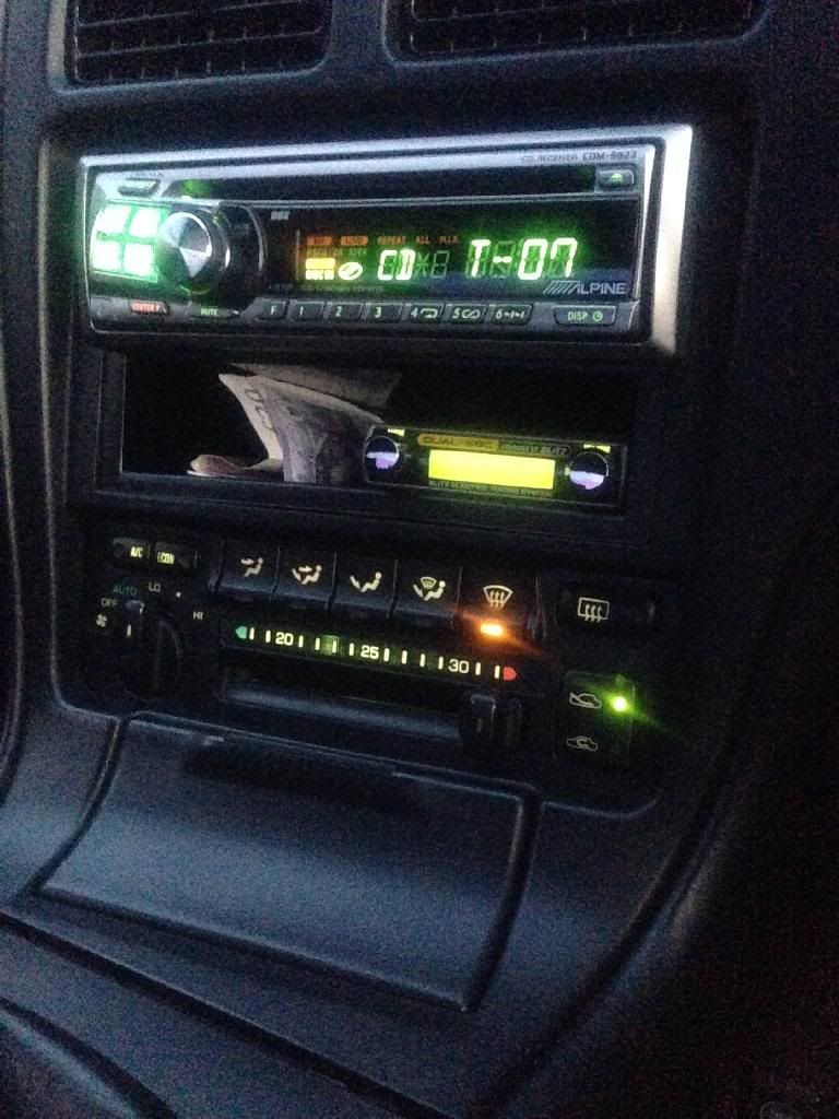

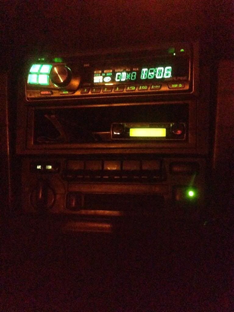

Another exciting update.
Since i bought the car the heater control never illuminated as they should,
so bought a new panel and replaced the bulbs and fitted it.
Old Vs. New
Another Job well done, Just waiting on some parts to arrive and Take some overall pictures

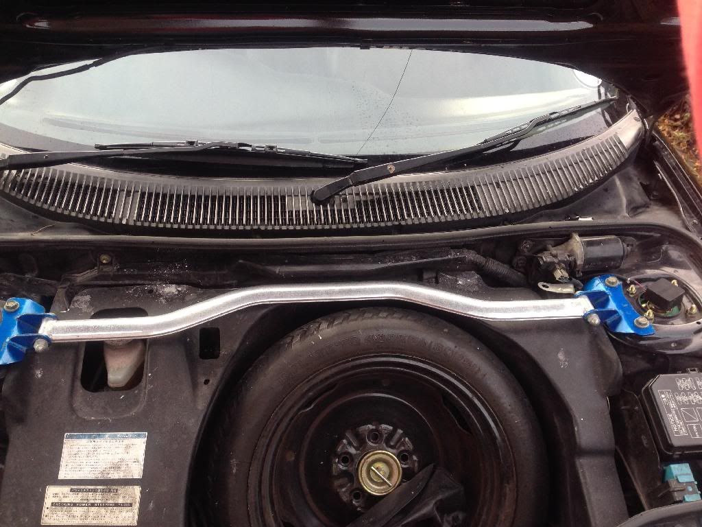

Fitted a Cusco brace that i got of Julian. Please excuse the dirty bay!

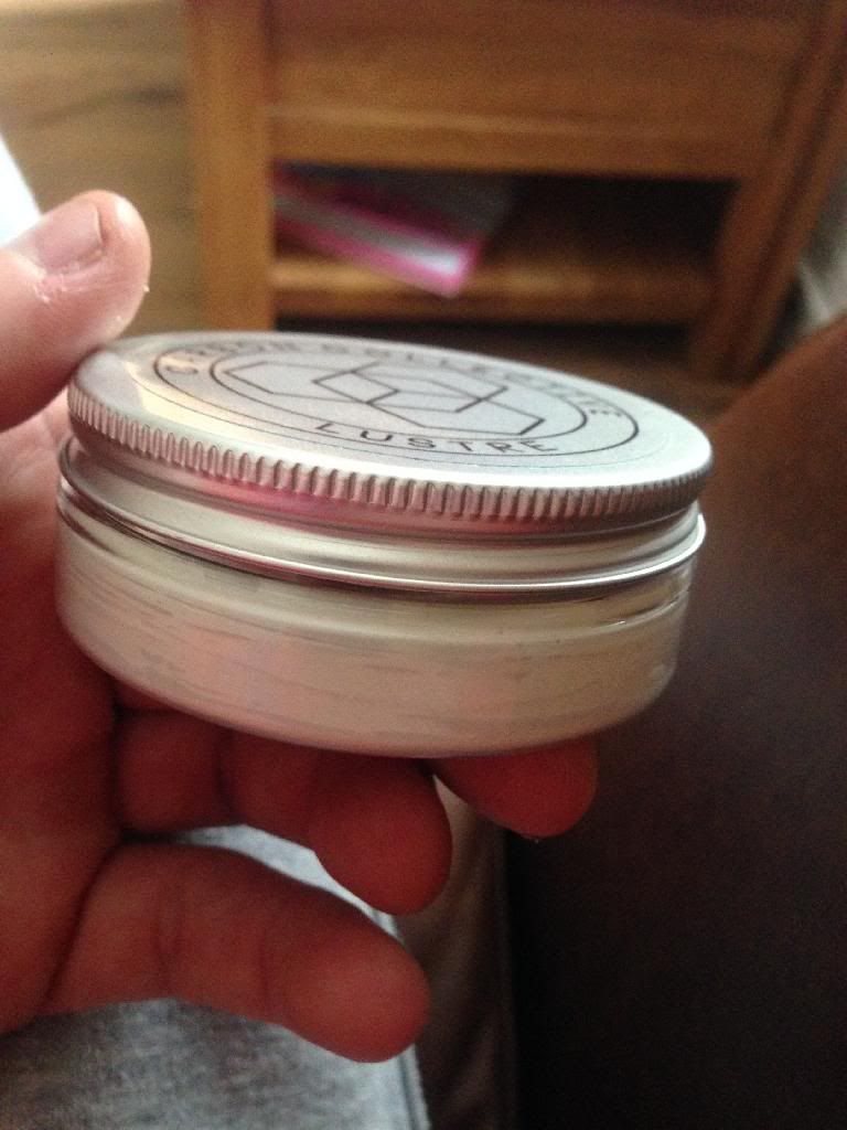

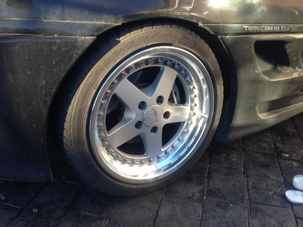

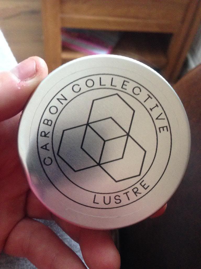

While the weather was dry i gave the wheels a quick going over with some metal polish, Just give them a quick going over, Going to have to get stuck into them and get them sealed up before the months out
Used some polish from carbon collective and will be using there wheel sealant too. Few people I know have been using the same products and have had great results.

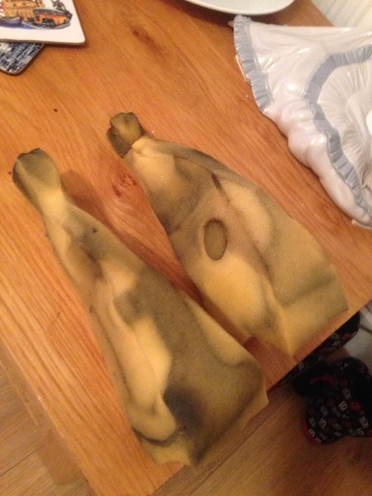

Well after reading a few horror stories about the foam in the sills I decided to remove mine.
Quickly whipped the trims off and reached in to pull them out, about as easy as your going to get.
Luckily for me they were bone dry and looks like they have been forever, result :D

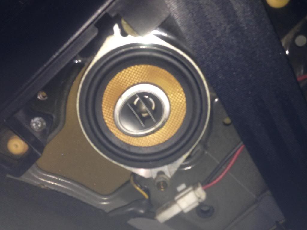

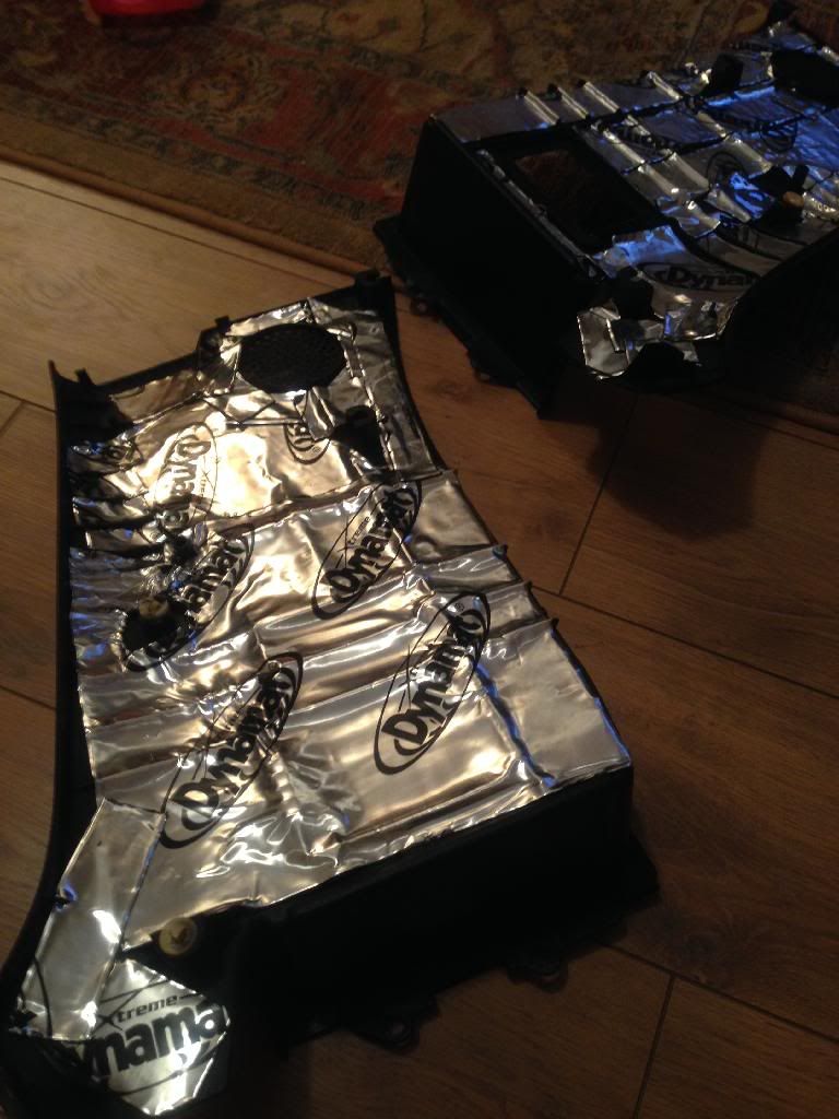

Whilst the trim pieces were off I quickly stuck some Dynamat on that i had lying over form a previous project, I know that is meant to go on the opposite side of the speaker but I'm not trying to create any improvement in sound quality I'm basically trying to eliminate some of the rattles :idea: I know quite a lot of people go the opposite way by removing excess weight etc but the sound deadening that i have added weighs no more than 1-2kg at the most. And is quite easily reversible.

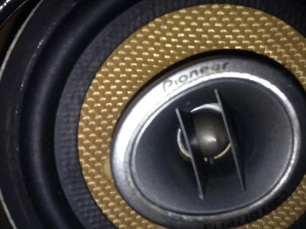

Also while the panels were off i noticed that i had pioneer speakers, That normal?

Nice looking 2 , great news with the sill rotter foams :thumleft:

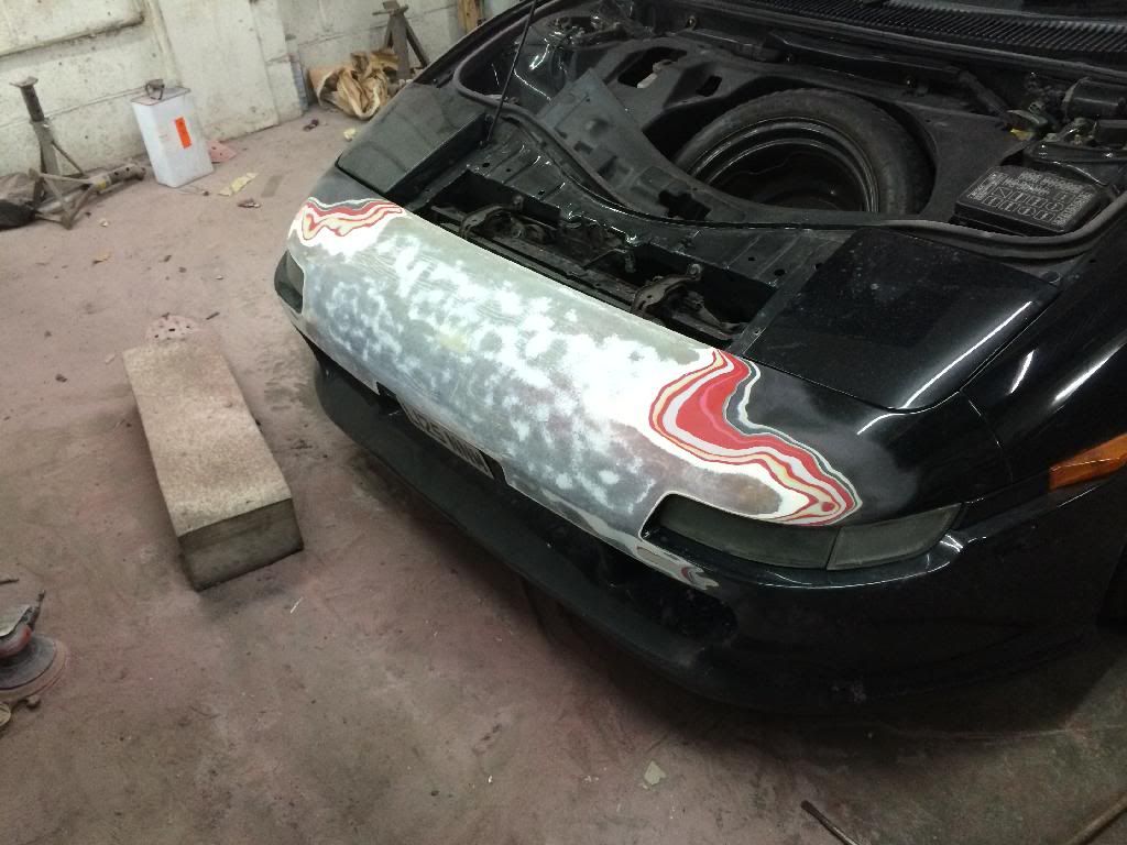

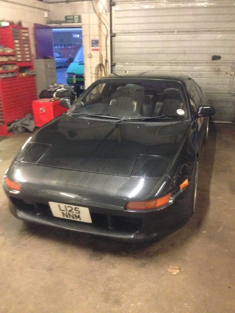

Front end looked a bit shabby so had the paint took back and had the bumper repainted. Looks so much better now

Another boring updated, got round to polishing and sealing my wheels today, but they'll need split and redone before the summer. And I'll most likely put them up for sale, trying to source some nice buddy club or advan wheels but with similar offsets

Keep your current wheels. They look real good all polished up and clean.

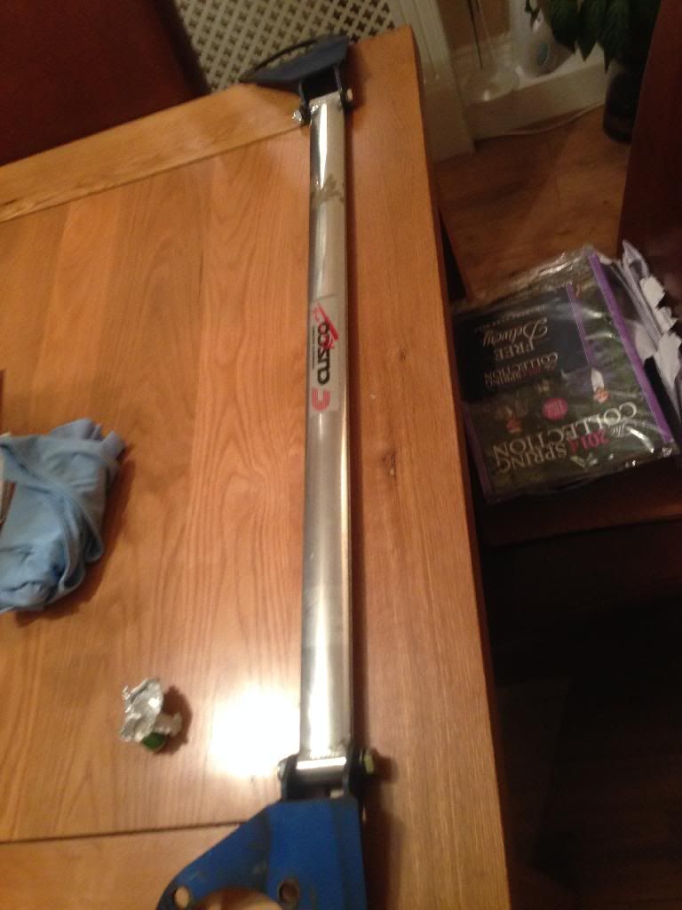

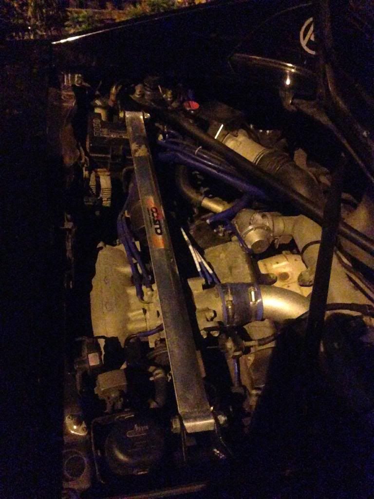

Bought and fitted a cusco rear brace. Going to put the oem black hoses back on as i've went of the blue ones. Going to slowly replace them with black silicone. Hopefully over the next few weeks going to paint the intercooler pipework black.
Anyway pictures of the brace.

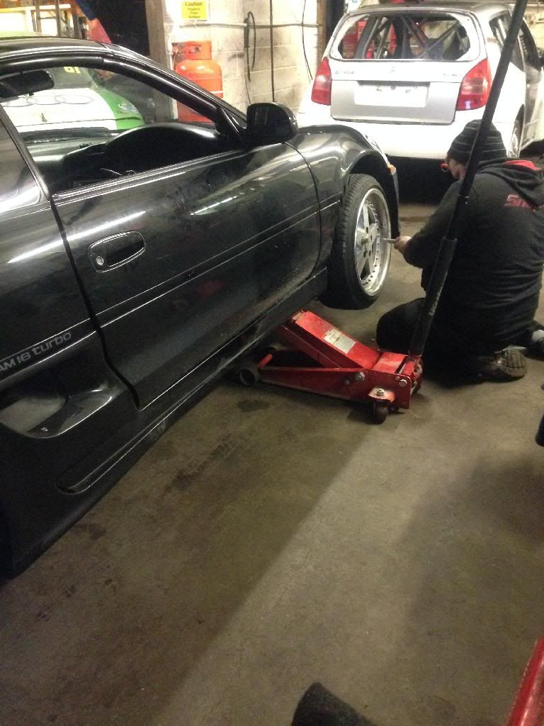

After trying to locate my steering wheel wobble at around 55/60 mph, i discovered that i had play in the inner rod end. Replaced that which has helped ever so slighty but hasn't cured my problem :(

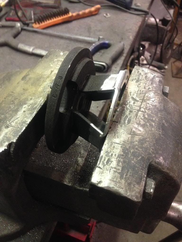

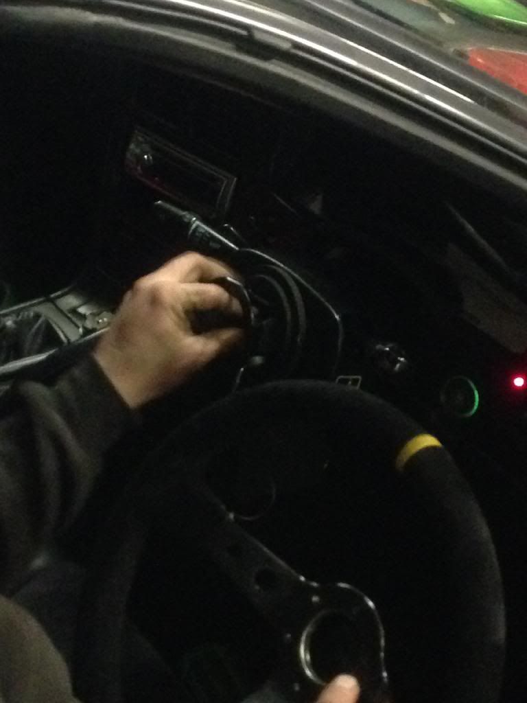

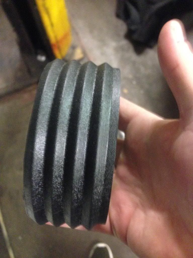

Next on the list. Since changing my steering wheel to a dished type it has stopped me from being able to reach the stalks and indicate etc.

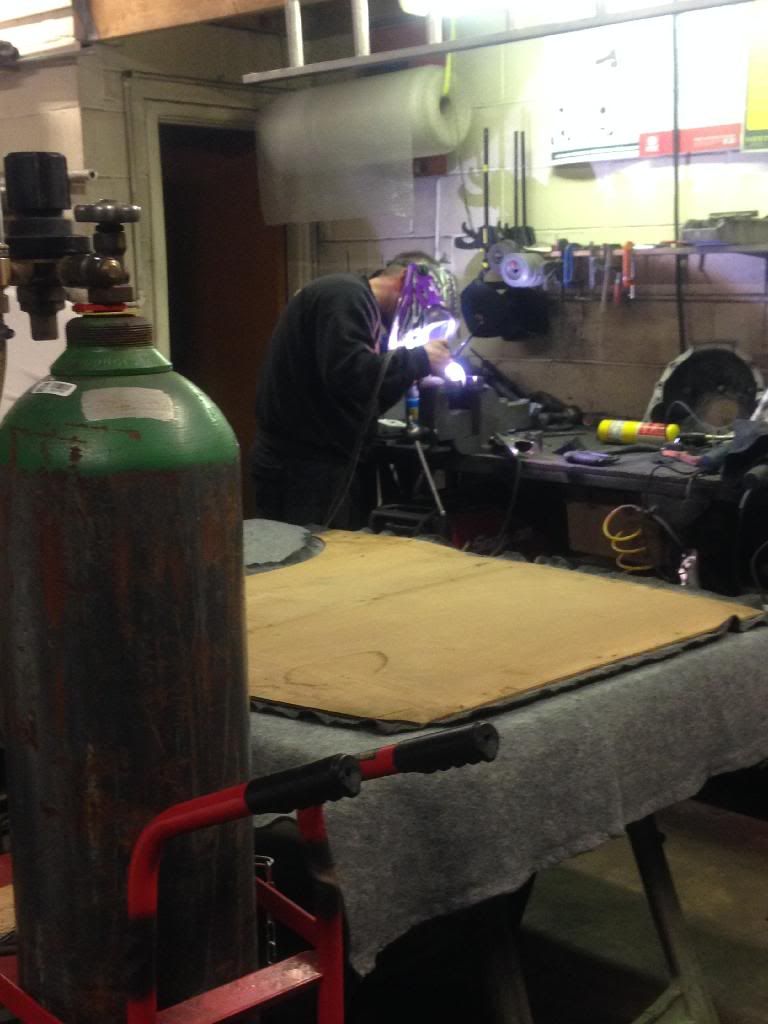

Whipped the boss off chopped a few inches off. Dressed the edges and prepped ready for welding. Got it welded, ground and fettle then gave it a lick of black paint before refitting. Had to shorten the rubber shroud that goes round the boss.
Jobs a good'un.

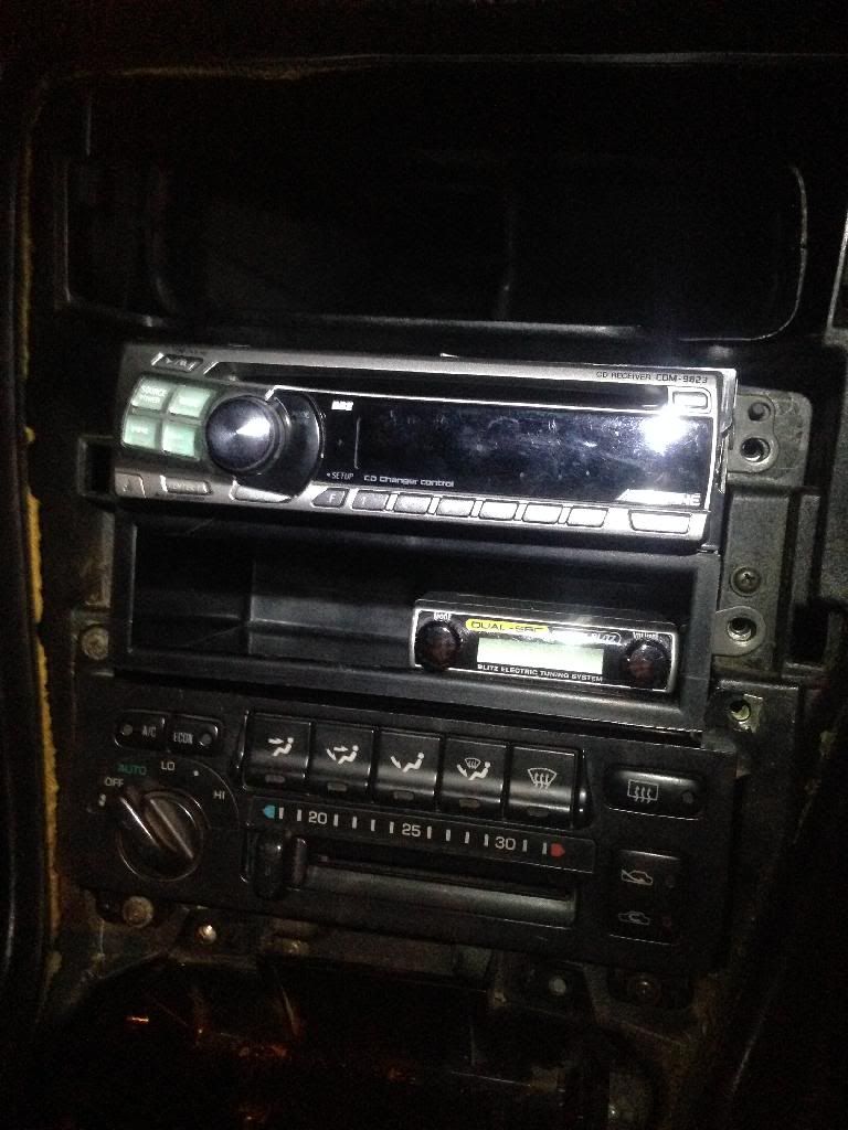

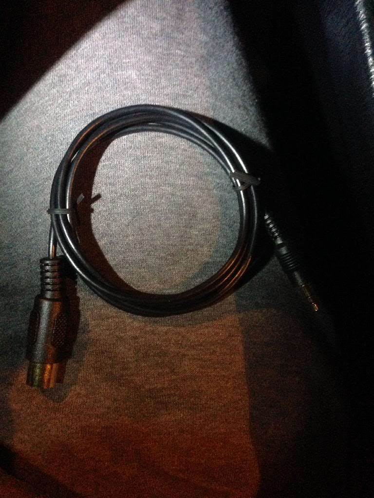

Next thing was to try and fit a cable from the cd changer port on the alpine head unit to audio jack. Unfortunately it doesn't work. My error in ordering the part. Its for the cdm9823R model and mine is only the cdm9823 :( anyway while the head unit was out i re-routed a few cables for the EDFC and the boost controller to tidy things up. Not that you can see them but i know they are there.

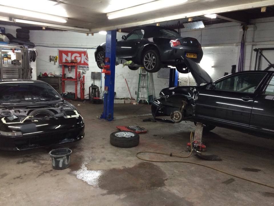

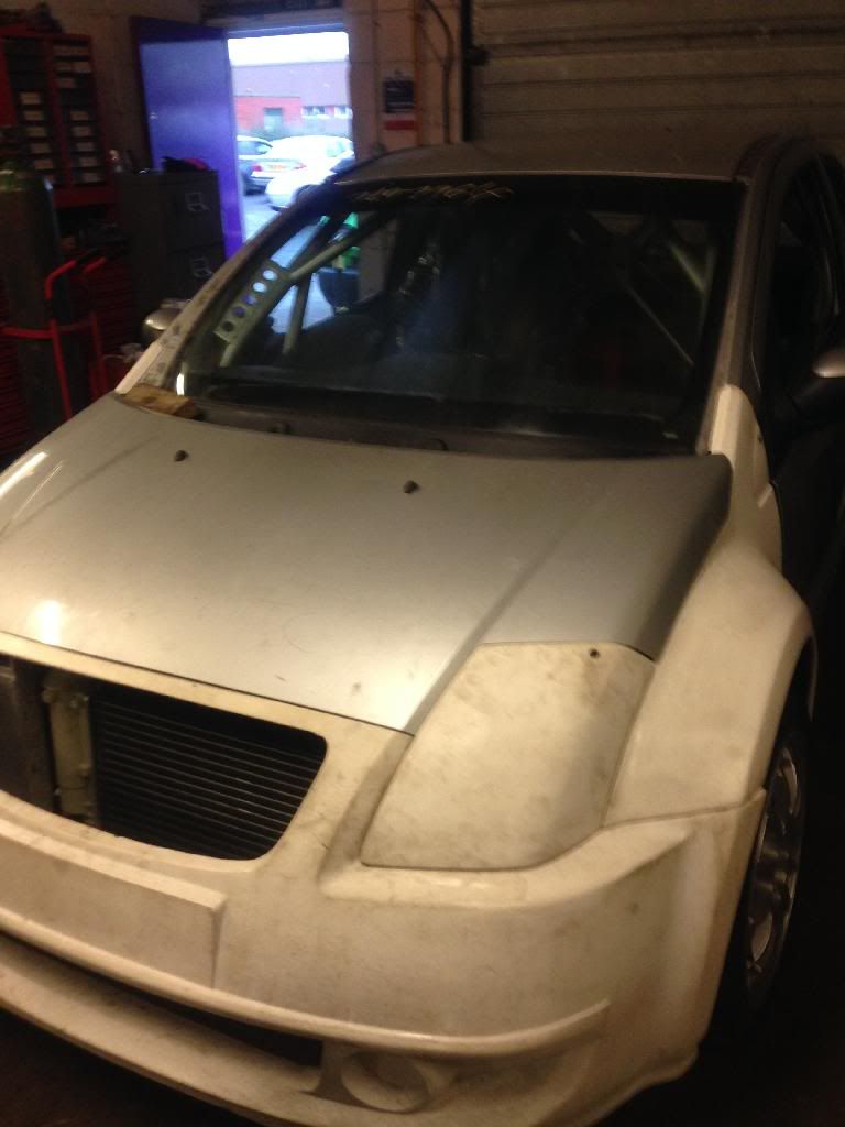

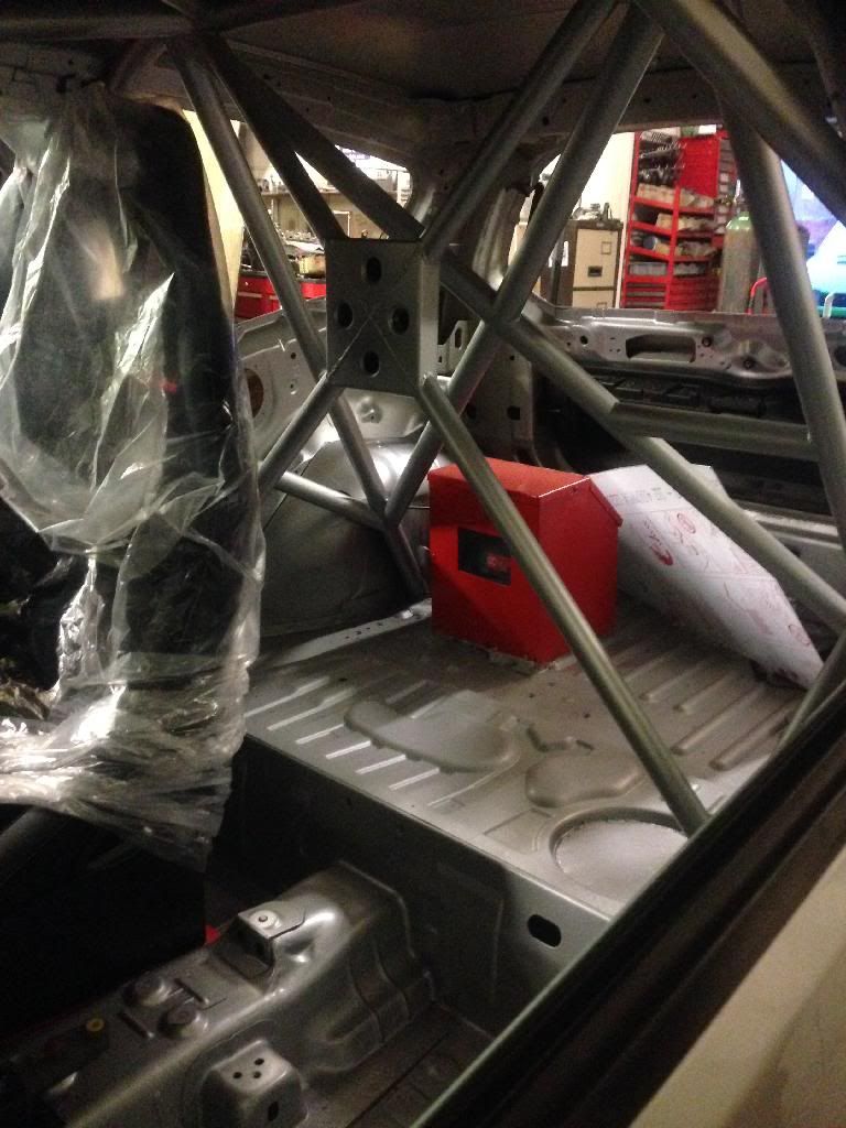

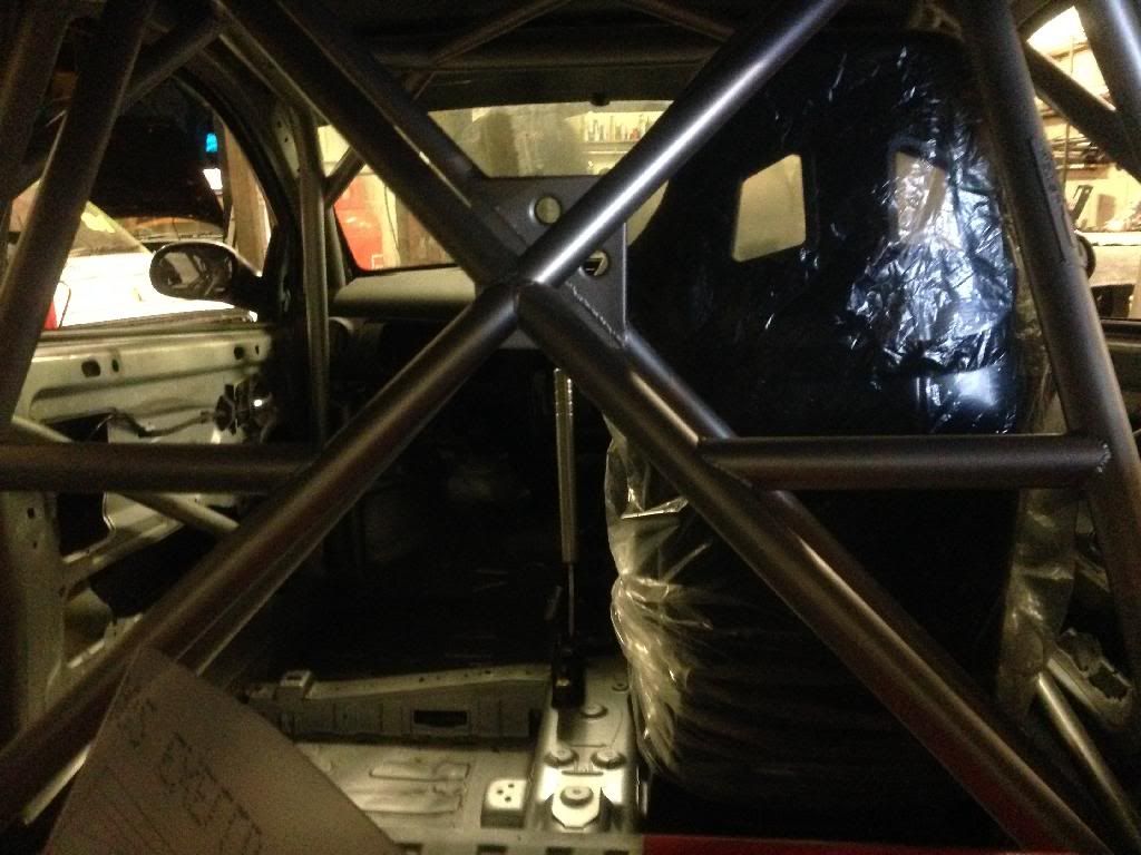

And yes that is a roll cage in the c2 in the back ground, its being built (not by me) for european rally cross championship. Still in progress but you can see the custom cage and hydraulic handbrake.
FIA approved bucket seat, another angle of the cage, the red box isnt a better box, theres a small fuel cell inside. :mrgreen:

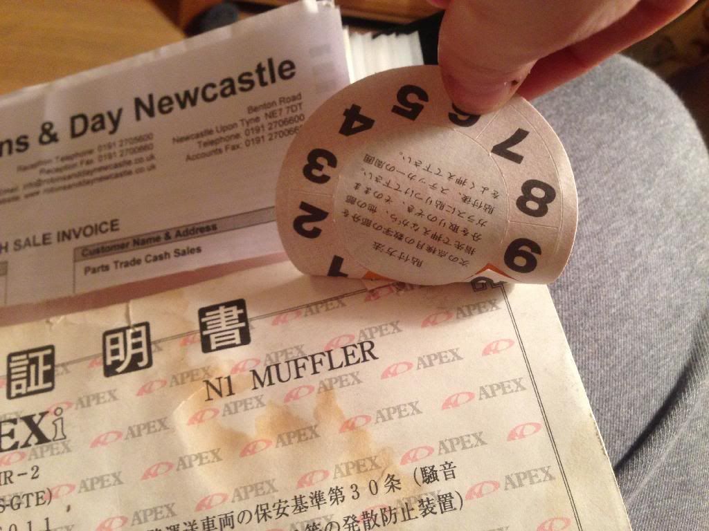

Nothing major to update this week.
Organised my service and general history into a poly-pocketed folder.

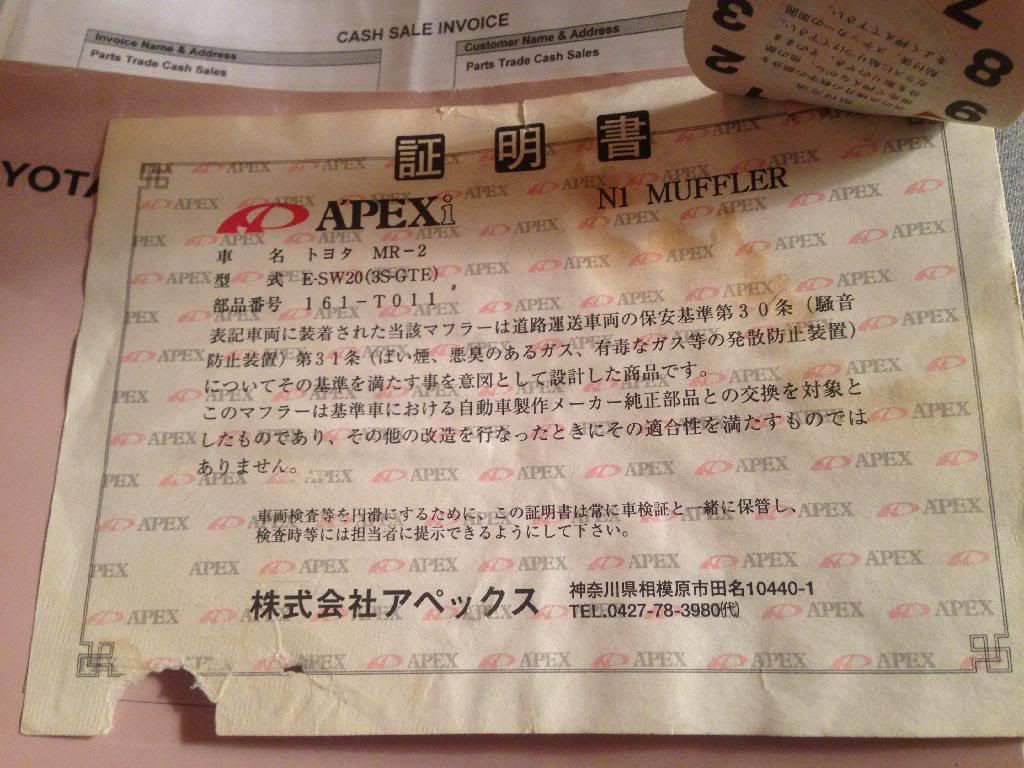

Come across a certificate of what looks likes a recipt for a apexi N1 muffler. Probably took off long before i bought the car but nice bit of infomation none the less.
Might start looking for a single exit as the phoenix power sits too low for my liking :cry:

Re: Mr2 Rev 3
Post by JAAASH »
Is that numbered disk a 'shaken' sticker (japanese mot)?
If it is, are you interested in keeping it? I've been looking but cant find them anywhere :whistle:

if you mean something like this. IIRC they are tax discs and not MOT "Shaken"
i thought shaken was...
Then i don't really know. Mine hasnt got a number in the middle, and is made from card, the one pictured (and most others) are like a vinyl/sticker.
Just get onto any graphics company and they will be able to replicate one for you.

You're probably right to be honest. I'm not 100%.
But ye, it's the vinyl window sticker im after. I'll have a look around for some companies to replicate one for me. Cheers.
