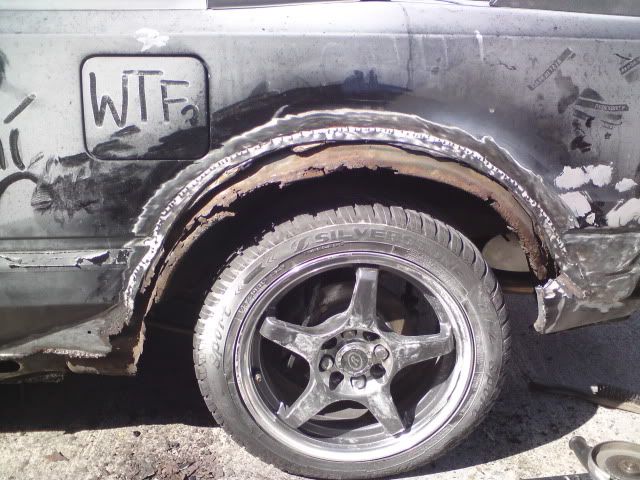

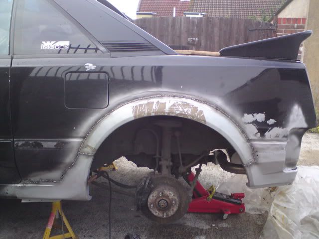

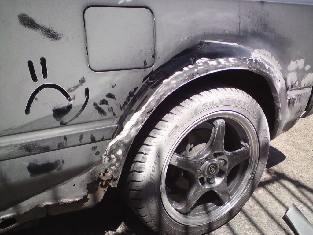

These are my pics, the rust had got a lot further than we had expected so the whole arch has been replaced. :)
We started to take off paint at the bottom of the arch as it was the outer sill that needed welding, took the grinder to it to find about half an inch of filler that I wasn't aware of :evil:
Then found that repairs had already been done (badly) so the whole lot had to be taken back to good metal. I sneezed for a week after this. 8-[

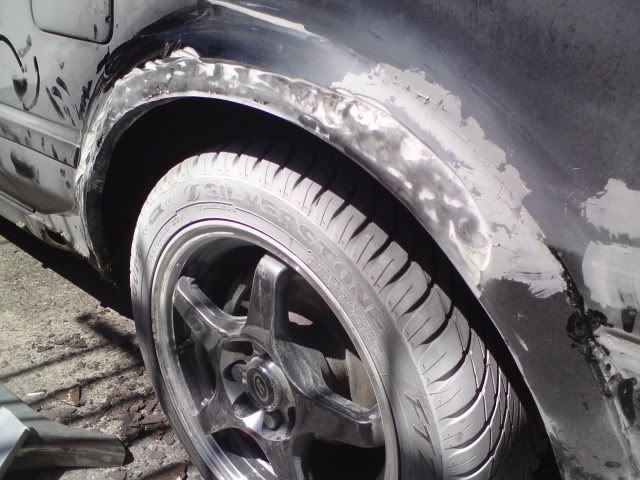

Still going with the grinder..
This was how far we had to take it back to get good metal...it looked awful
:( All the inner arch had to be cut away too and we replaced it with fiberglass.

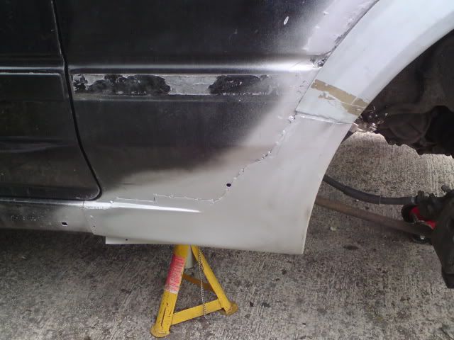

New sill return in...

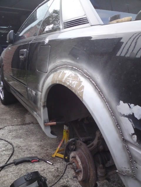

New arch lip in...
And all done apart from a skim of filler and paint....
Huge thanks has to go to my partner Limeymk1 for the repairs, it was the first time he'd attempted something like this and he did a top job. 8)
You probably wont have to go to that extreme but I hope the piccies help :mrgreen:
