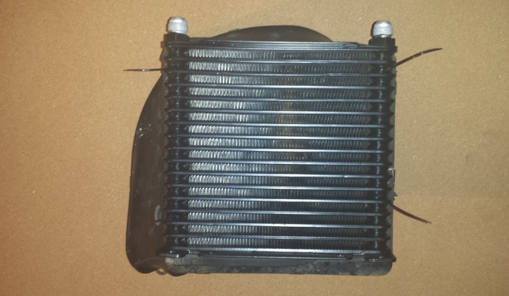

I have been looking at oil filter relocation kits to move my filter on my rev2 turbo from its current location to the drivers side corner in the space behind the strut tower and forward of the boot.

audicab26 wrote:I am not sure how to mount a small cooler rad where it will be effective.Has anyone got any pictures of one mounted and it location any help would be welcomed

Shmed wrote:That looks like a really nice fit, almost OEM![]()
Shmed wrote:With a stat, the oil temp should be fairly stable shouldn't it(assuming adequate airflow through the core)?
Shmed wrote:Out of interest, what temp does the stat open?
Shmed wrote:I seem to remember asking Opie about'optimum' oil temp and being told that around 110 degrees is pretty good?

Race Idiot wrote:Would it be a good idea to fit an air to air oil cooler if I switched to a TD05 which is only oil cooled?
I like the idea of using the IC shroud though, I also run a 205CC but at the moment I have an NA enginebay fan in place.
(my Radtec is in there so not an option, though the new car has a differnt core
Out of interest, what temp does the stat open? I seem to remember asking Opie about'optimum' oil temp and being told that around 110 degrees is pretty good?
