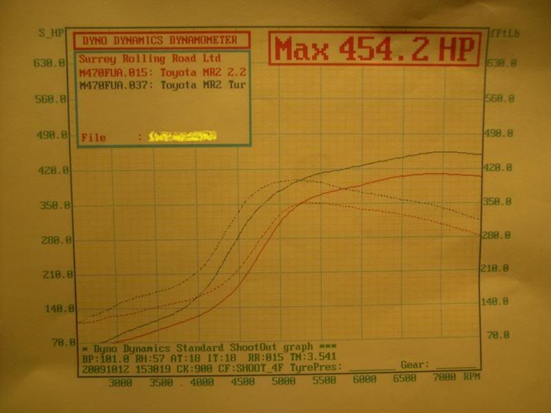

We have been testing some new chargecooler cores for over 6 months now on different mr2's and as a result can now offer complete systems that beat others on price
price but massively improves on performance.
The kits we offer are fully custom fabricated so are a supply and fit price only. We tested our middle size core option against what we knew to be the leading
product on the market, in the dyno plots provided you can see how our kit improves performance in so many ways. Lag is reduced by a comfortable 500 revs, torque is improved
by a massive 100 ft/lbs, overall power increased by comfortable 50 hp. All these figures were gathered on the same dyno, and same operators the only difference being the chargecooler core was swapped.
In the dyno plots the blue lines are those for the new core, the red lines for the old.
A independant mapper (Ryan G) commented that the power increase was due to reduced intake temperatures, improvements in core flow rates, and general design of the core.

Ok then here's a teaser.

just interested
i know the blue line is with your uprated c/c but i also note that there is about .25 bar more boost ~ 3-4 psi that could account for 50 bhp in itself
I appeciate the increase in spool a better core can make but i'm having trouble why there is more boost full stop , IMO the boost controller should have kept the boost in check ie the same as the first run
just hardly seems a fair comparison as obviously more boost = more power

So was the radtec chargecooler working properly and given a fresh dyno run before the swap, it's just that on other cars with similar setups the radtec is holding it's own, defo no where as large a gaps as stated [Think]
Would also like to see the power differences between a rev3 with all the bolt ons running a st205 chargecooler then changing the cores [Think]
Ryan did try different boost levels to see if anymore power could be made.
The car made the same power at 1.5 bar according to Ryan, this just happened to be the one printed by the dyno chap.
James
