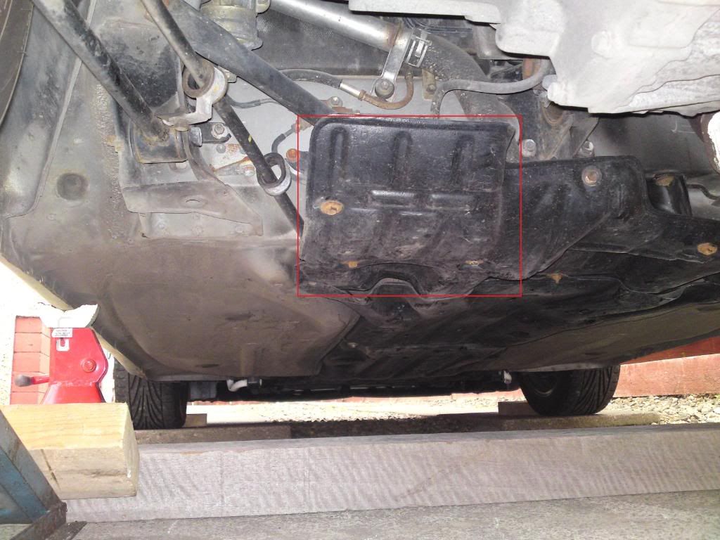

First of all, get the rear end of the car off the ground by means of ramps (like mines) or a couple of jacks with the addition of axle stands. (Yes, i am also a shameless pic whore! Just look at that Blitz and ARB!! :mrgreen: )
Now remove the undertray using the 10mm spanner/socket

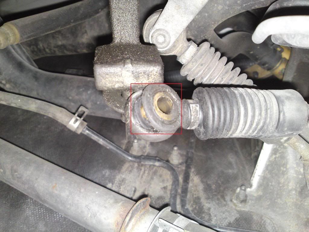

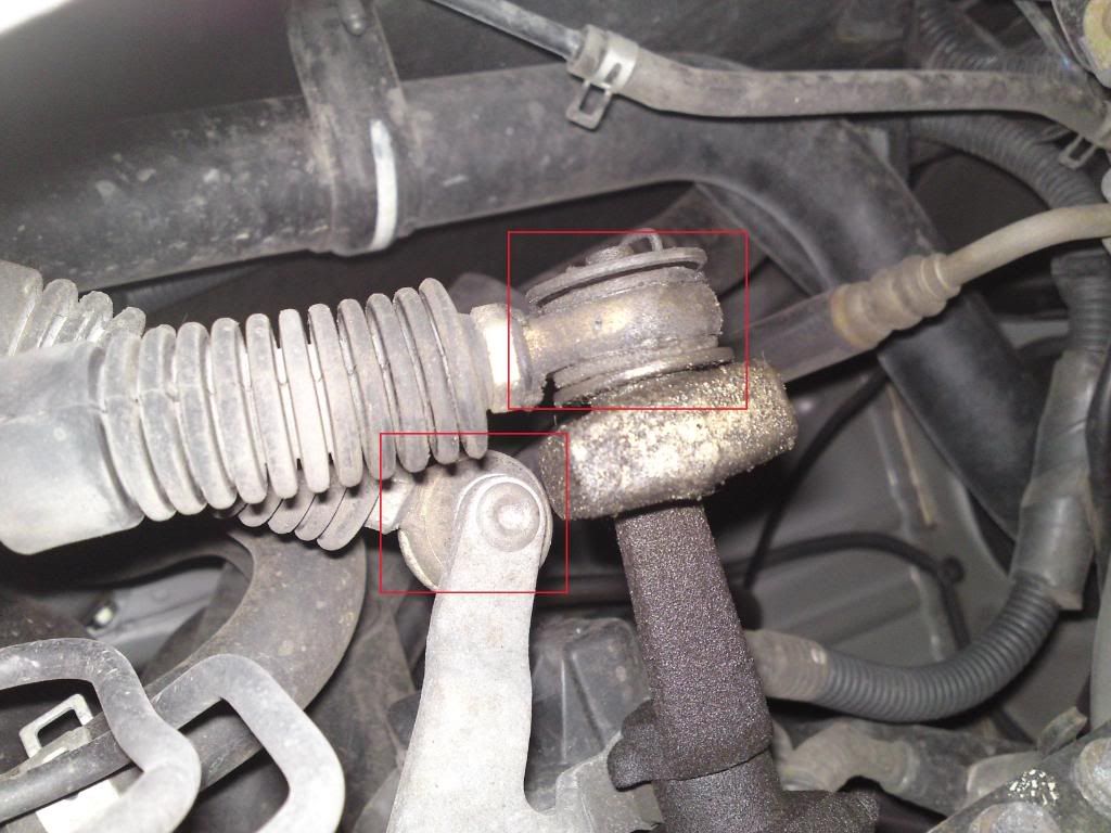

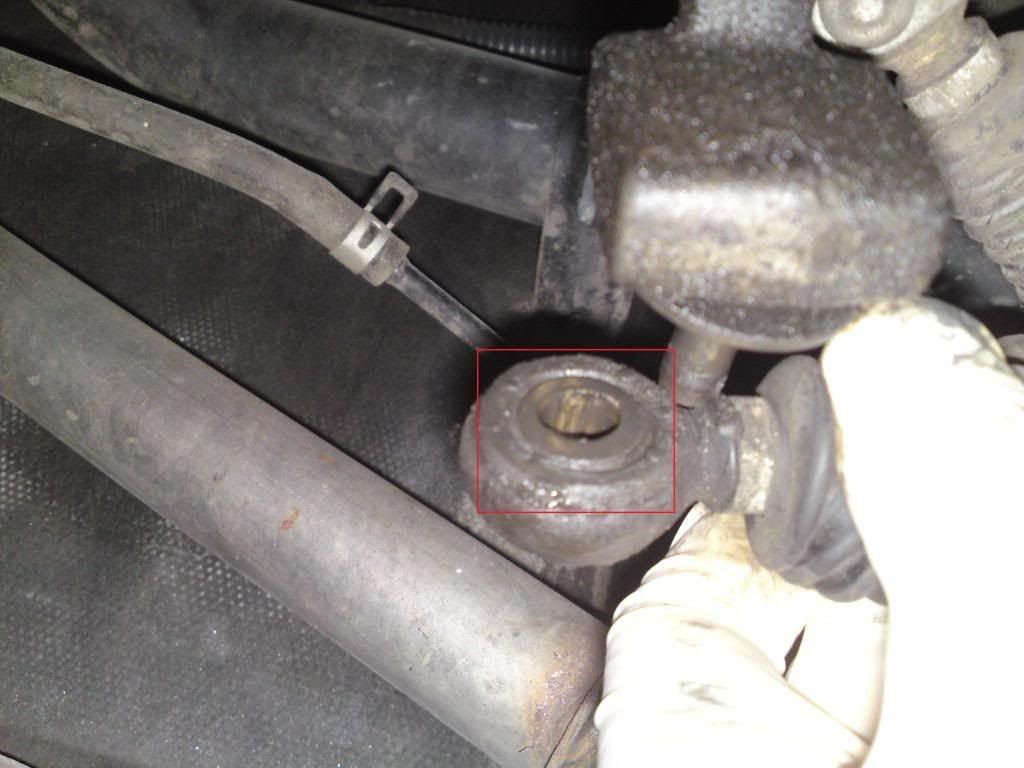

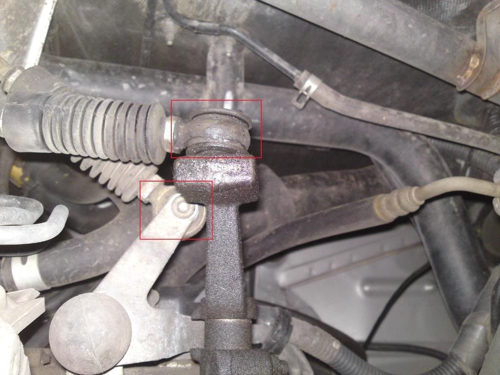

Here is the two gear shift selectors. The bottom one is forward drive, and the top is reverse.

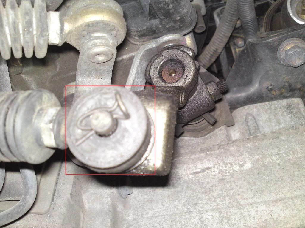

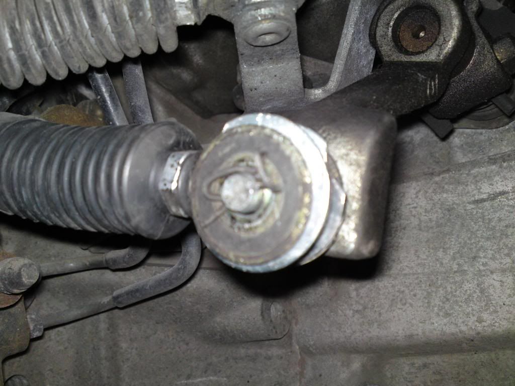

Now remove the safety clip/pin on the top, and slide the bush off the pinion.

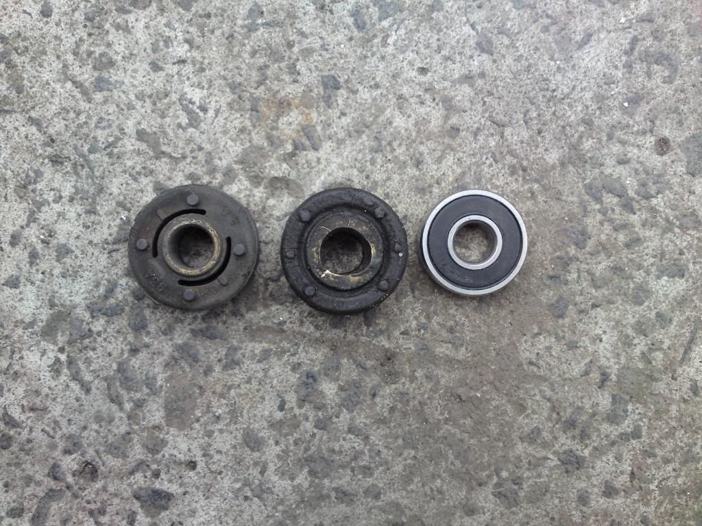

Using the thin plain screwdriver (and a bit of force) remove the original bush.

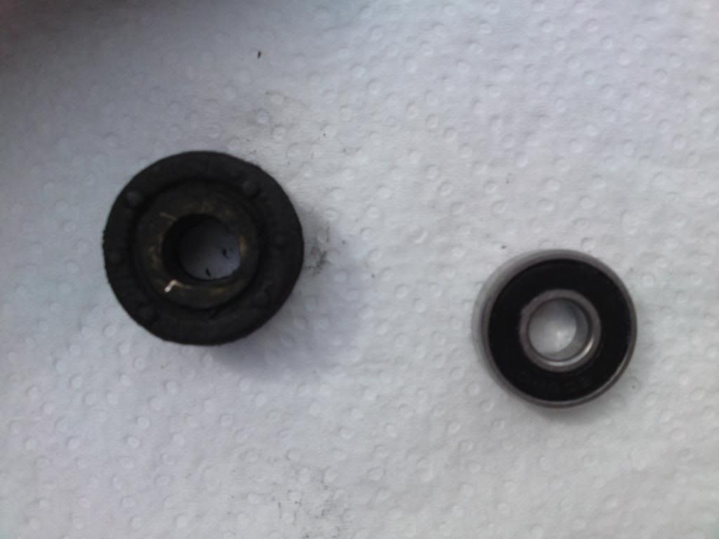

Upon inspection mines were pretty buckled!

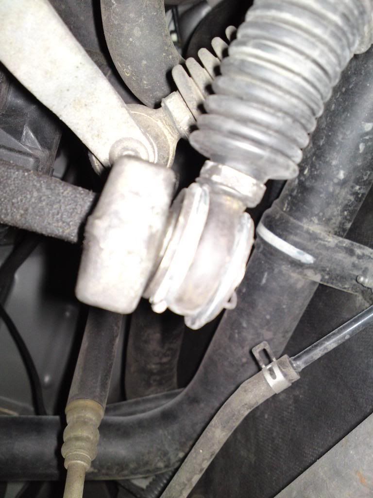

When the original bushes were out, i cleaned the bush/bearing housing, original washers and pinion. I also sprayed a bit WD40 on the pinion to aid the insertion of the new bearing. Once this was done i fitted the new bearing in the housing. It wouldn't fit first attempt, so i had to gently chap the bearing in the housing with my rachet!

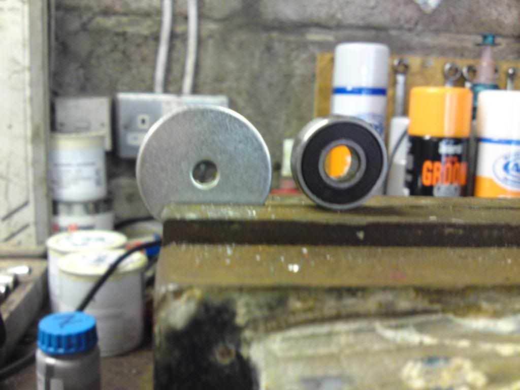

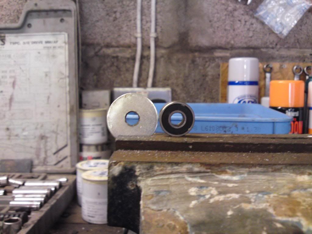

At this point i had to rebore three 5mm diameter repair washers to 7-8mm by using a drill. I then used a grinder/wire buff to remove any excess shards of the washer to ensure a perfect fit.
Before:
After:

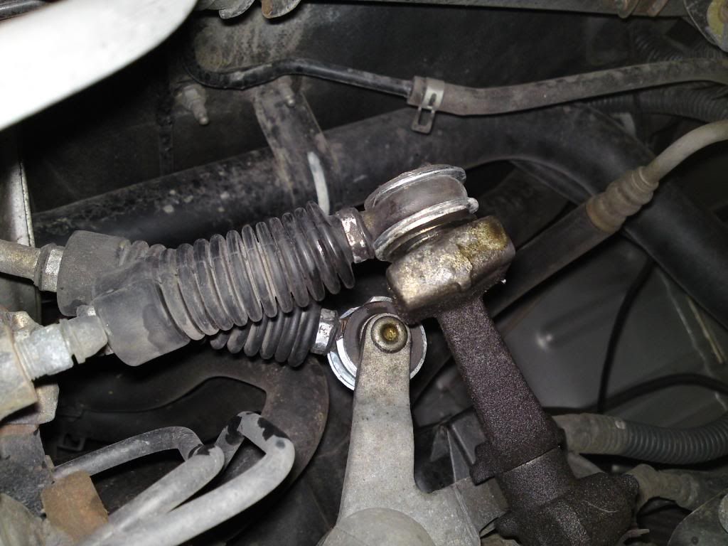

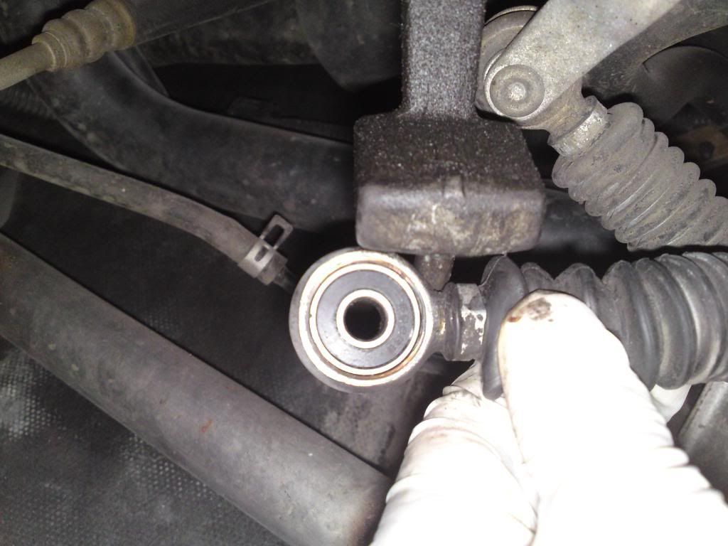

I then fitted the washers, the new bearing and the safety/security pin.
I then repeated these steps for the reverse (top) gear-shift selector bush/bearing.
Here is the finished article!

One point though, you say that one of the cables is forward drive and the other is reverse - aren't the cables 1 for forward&backward and 1 for left&right movement of the stick?

They do the same job as the parts in your first link, except these ones you have to pad out with washers a bit. Both the bearings in your link, and the bearings we are talking about go on the engine-end of the gearchange cables, where they attach to the gearbox.
