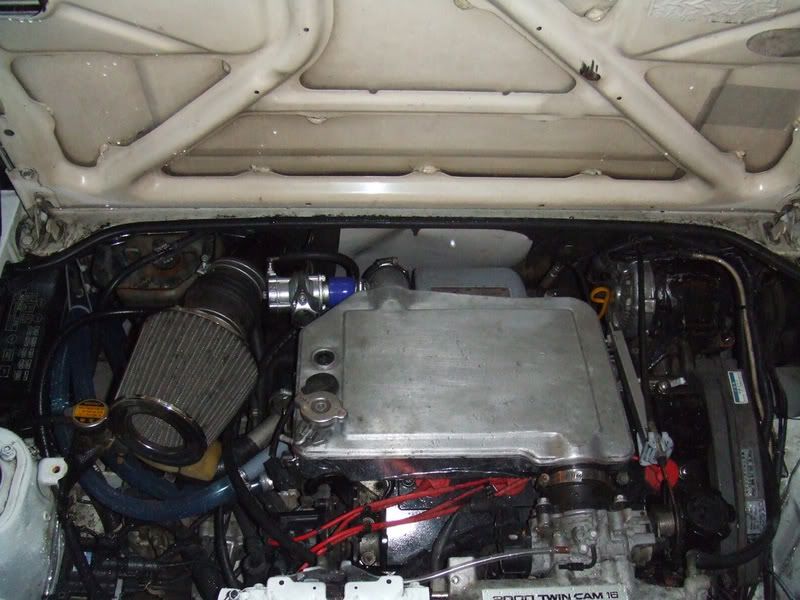

This is how my ST185 chargecooler conversion looked on my old rev 2 Matt.
Brook.

Ah thanks for that :thumleft: Its quite neat!

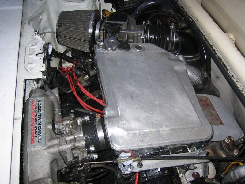

here is my st205 install
cheers karam

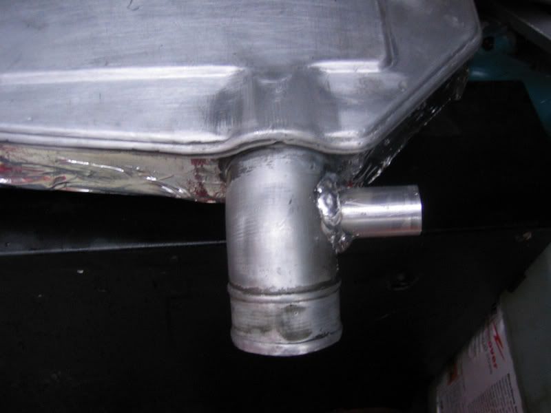

Heres my st185 install, modded to allow an aftermarket BOV to be fitted.

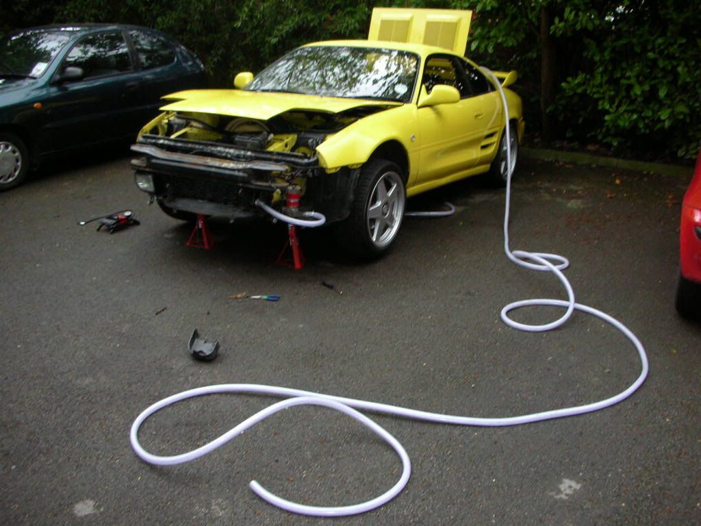

I had the st205 - plugs not to bad at all, disconnect from turbo and inlet then just lift up!
haven't got any pics of it finished on photobucket, but heres a mid installation pic from the front! (my old 2)

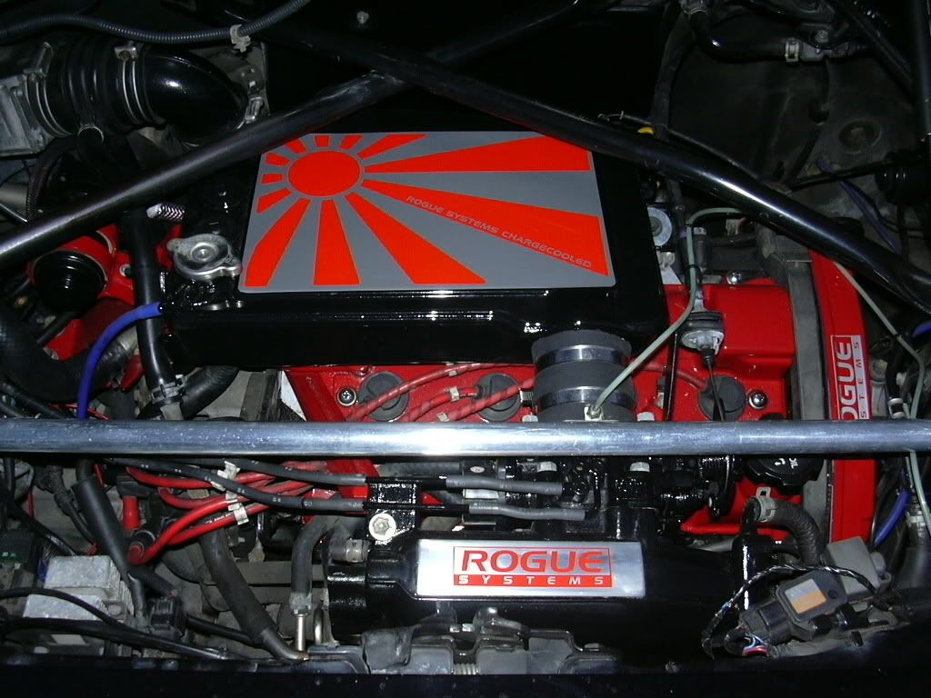

here my st205 install....
