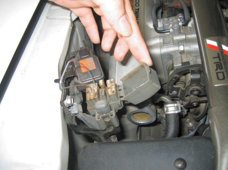

3. Unclip the lid of the “diagnosis” port on the rear of the engine bay and insert the two ends of the bent paper clip into the holes labelled TE1 and E1. This prevents the computer from varying the ignition timing electronically while you are trying to adjust it.
Diagnostic port - click for full-size imagePaper clip in diagnosis port - click for full-size image

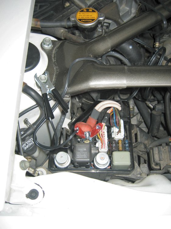

4. Remove the lid of the fusebox in the opposite corner of the engine bay. Connect the positive lead of the timing light to the large power cable in the fusebox. Connect the negative lead to a nearby grounding point; I used one of the bolts holding down my strut tower brace.
Engine bay fuse box - click for full-size imageTiming light connections - click for full-size image

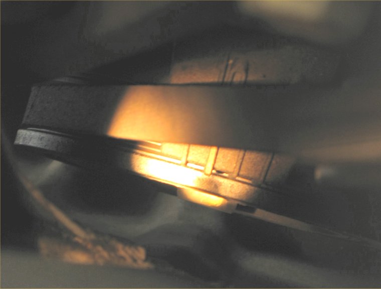

6. Shine a flashlight down between the two intake pipes that lead to and from the intercooler. Below the alternator belt you should be able to make out the timing marks that you will use to set the ignition timing. Use the photo below for reference:
Crank pulley timing marks - click for full-size imageAnnotated timing marks - click for full-size image

8. Shine the timing light down between the intercooler pipes and watch as the mark on the crank pulley is illuminated as it passes by the timing marks. If the mark is nowhere to be seen, make sure you have the timing light pickup connected to the #1 spark plug wire.
9. If the mark on the crank pulley does not line up with the 10° BTDC point, then your base ignition timing is set incorrectly.
