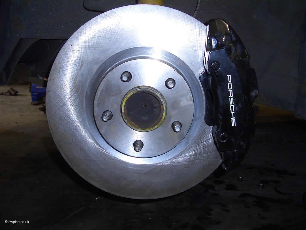

i've got the RX8 discs (front) on the rear, spaced out stock rear caliper. Front is running Supra discs and 996 Porsche calipers. Car doesn't want to swap ends, stops fine, no more sticking front calipers every six months. Run stock pads and doesn't squeal or eat wheels with the dust and yeah stopping power is there. Brake bias pretty much standard by intention and careful caliper choice. It can be done but a very emotive topic.

get something useful like these then
Re: Big brake conversion rx8?
pbmr2 wrote:get something useful like these then
Please don't
haha, yes that's usually how these threads go.
That porsche brakes look amazing
raptor95GTS wrote:haha, yes that's usually how these threads go.
Didn't realise you had Crono wheels aswell
heh heh that's what got my attention on your wheel sale
