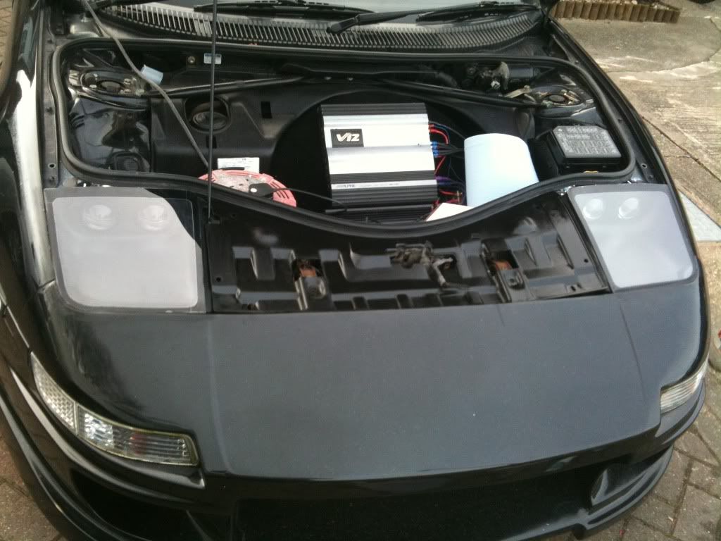

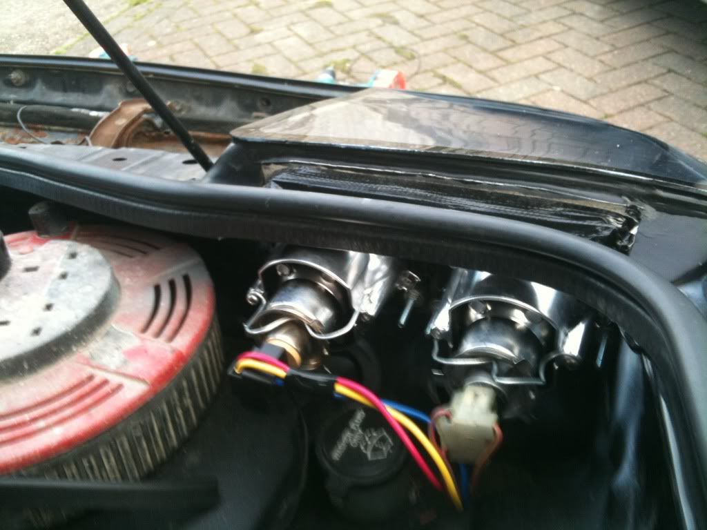

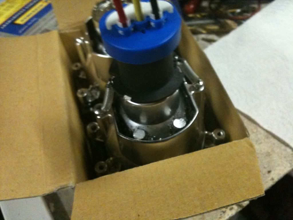

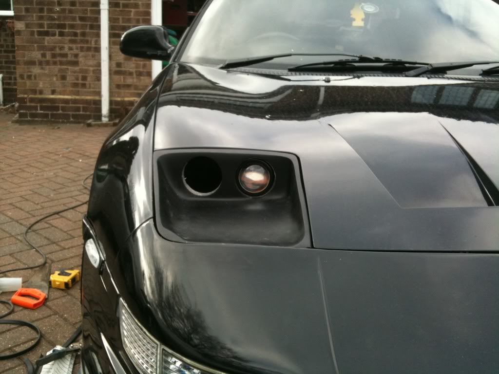

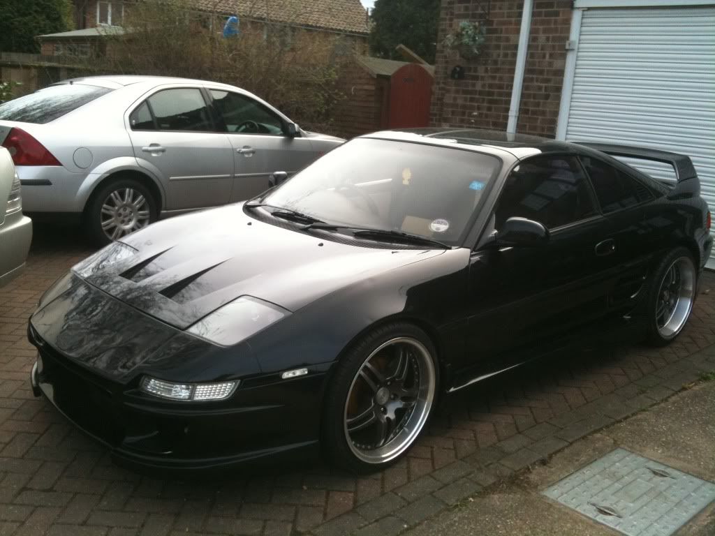

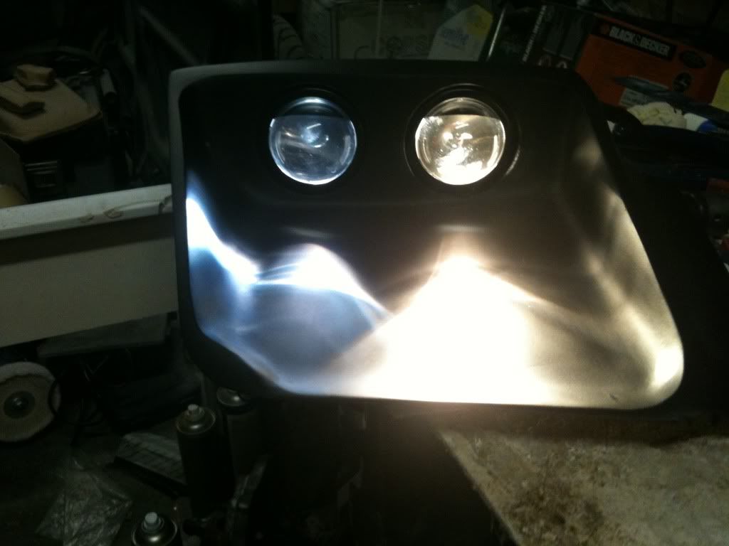

Hi everyone, as some of you know i've been after flush headlights for a while now. After searching for an age, i've discovered that there are no 'off the shelf' kits available so I set about making my own .
Hopefully i'll be able to reproduce them for other people if there's enough interest although it's still very early days but i'll keep this thread updated as I progess :th:
Progress so far :

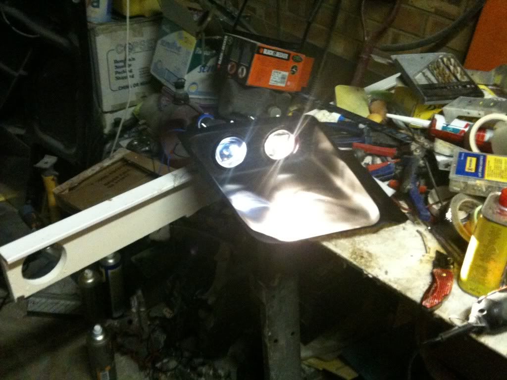

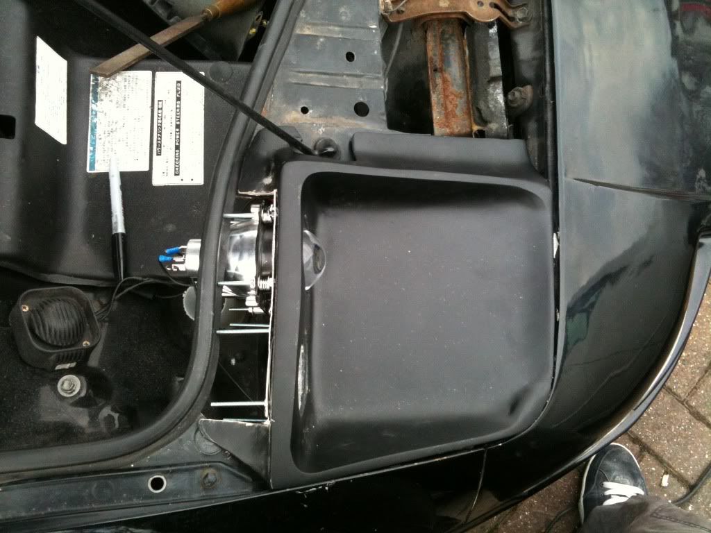

Found an uber rare set of fg buckets and copied one for trial purposes

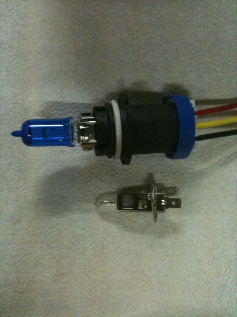

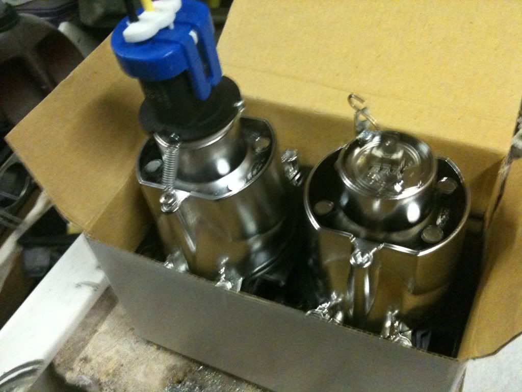

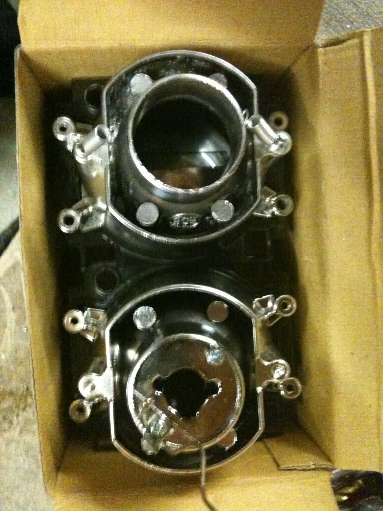

Sourced the projector lights (only bought one so far to keep costs down in case it doesn't work ):

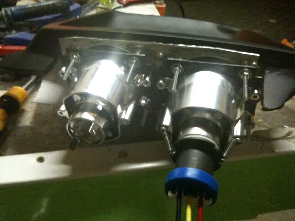

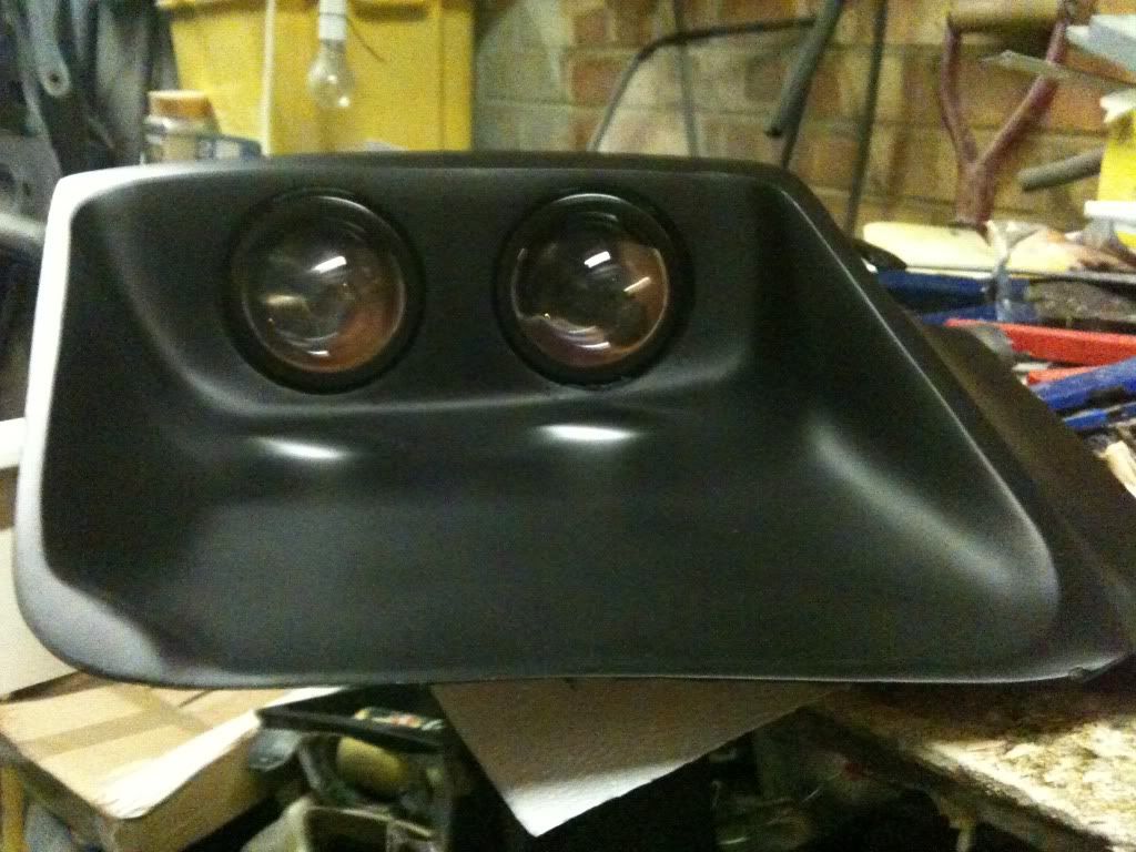

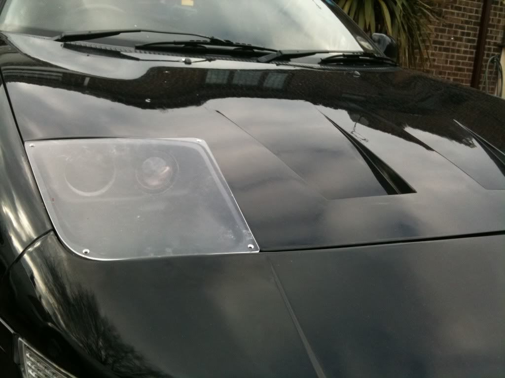

Cut light holes and mocked up how the lights will fit :

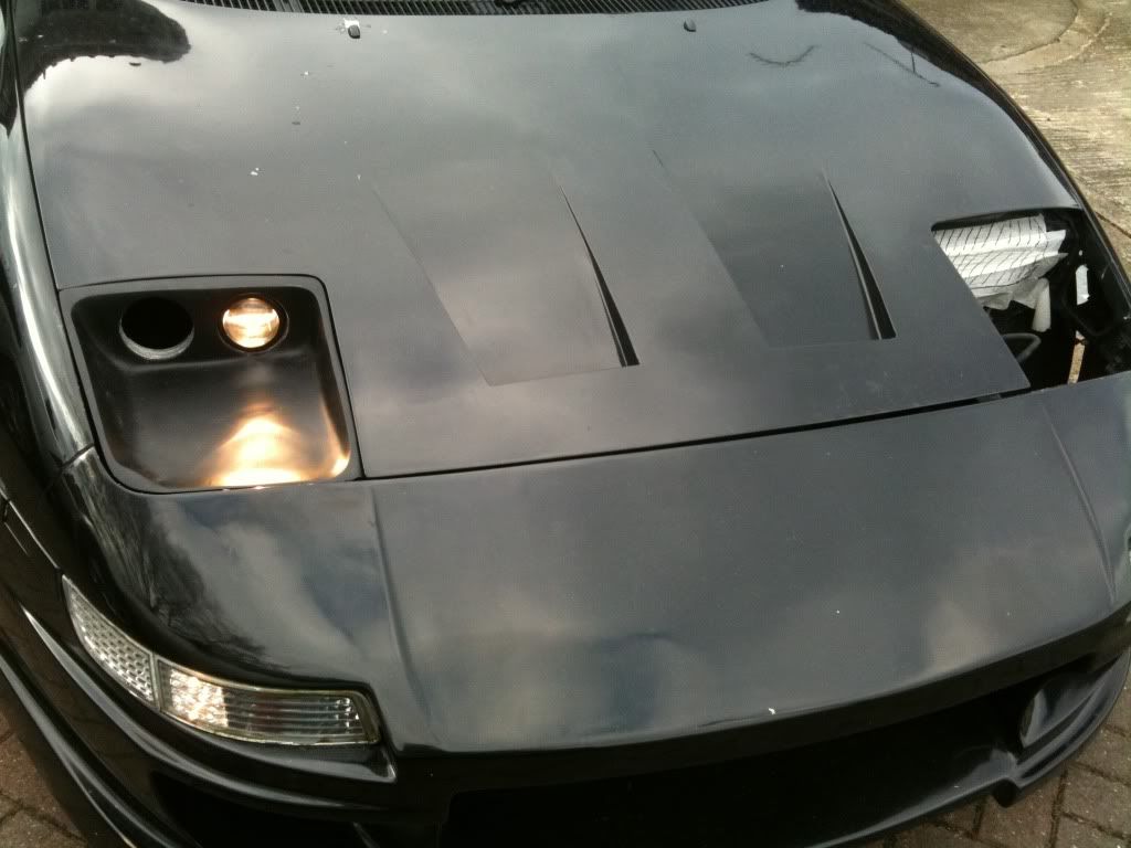

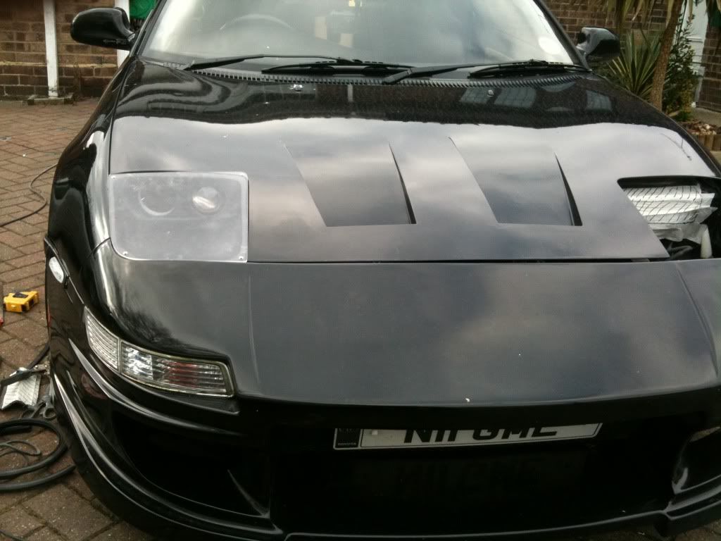

Roughly trimmed to fit and a mock up of how they'll look on the car:
I still have lots to do but looking good so far :th:

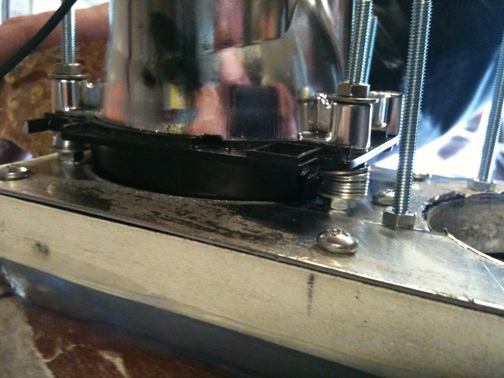

How do the beams get adjusted?
I was thinking about this and it might be best to mount both lights to an alloy plate and then adjust the plate.
Also, from what I've read, the hard part is making a shaped perspex/polycarbonate cover for the lights.
I seem to recall there's a guy somewhere who makes something similar and he reckons only one in three covers turn out acceptably curved.
I guess the trick might be to lay the polycarbonate over the top of the original light top panel then heat it up so it relaxes against the panel.
Not sure about how you'd bond it to the fibreglass pod though.

Si_Crewe wrote:How do the beams get adjusted?
You've got the whole lot in one mate !
The lights will indeed be fixed to a seperate panel that will be adjustable and the covers will slip in over the lights. As for the perspex/polycarbonate covers, i'm thinking the exact same idea about using the original metal covers as templates but if it doesn't work i'll see what they look like colour coded without covers.
Worst case scenario is I will make a mould for lenses and get a moulding company to make polycarbonate covers.
The lenses would have to be bonded to the fg buckets but all the fixings are going to be external so it shouldn't be a problem

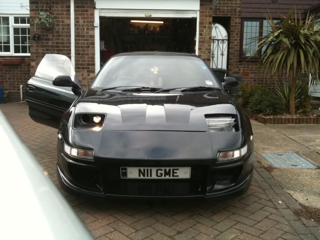

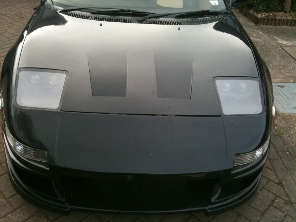

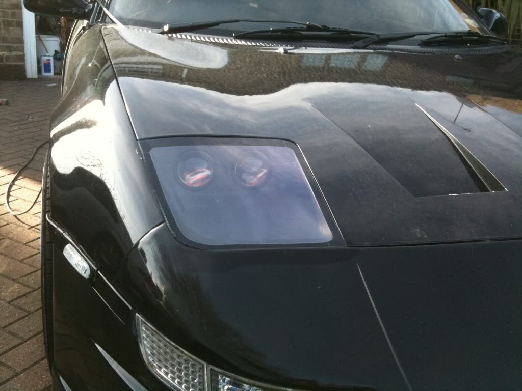

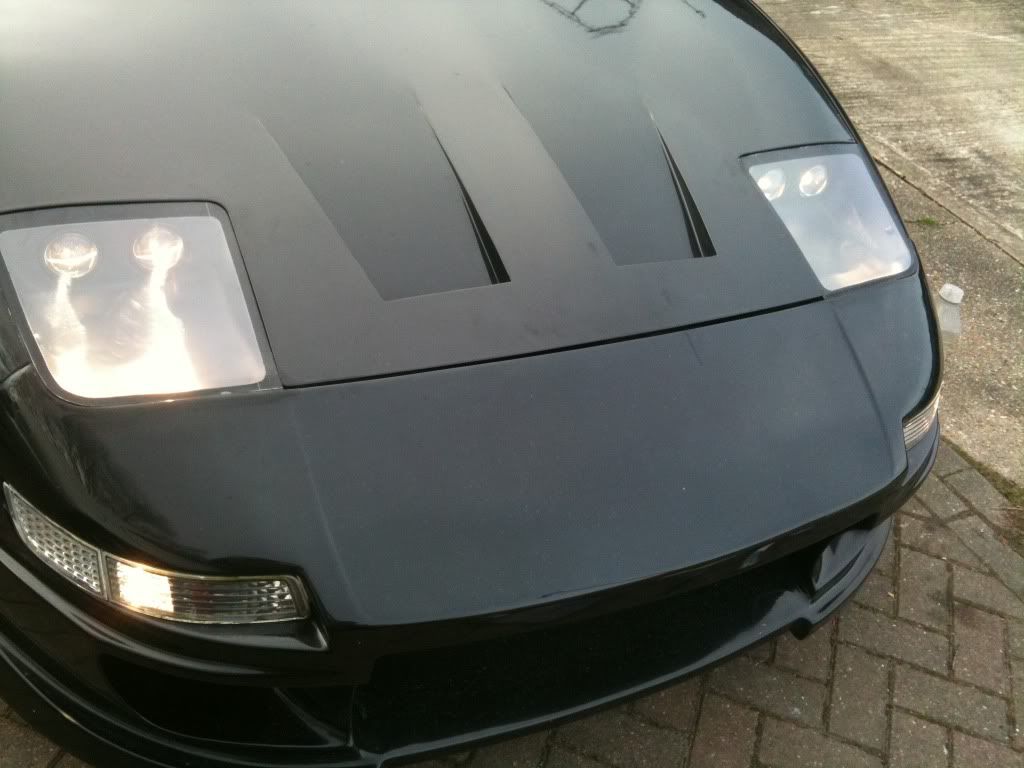

Thanks for the comments guys, especially Rogue (Patrick ?) for the pics - I can see how much work went into those although they do look ultra cool
Bit more progress this weekend but the filling/sanding is getting really boring now so i've decided to give myself the night off - although it's getting there
I have to admit, I too am guilty of loving the novelty of the pop ups but I feel they spoil the lines of the car when they're up - flush ftw

TBH, the main thing that'll grab my interest about a headlight conversion won't just be the way they look on the car.
It'll be some good pictures of the mechanism which shows how the beam adjusters will work and how it's all mounted to the car.

These pictures are from about six years ago. You couldn't buy angel eyes off the shelf back then, let alone from eBay for $10! We custom made them in-house from acrylic rod. The customer specified the colour of the LEDs that illuminate them.
