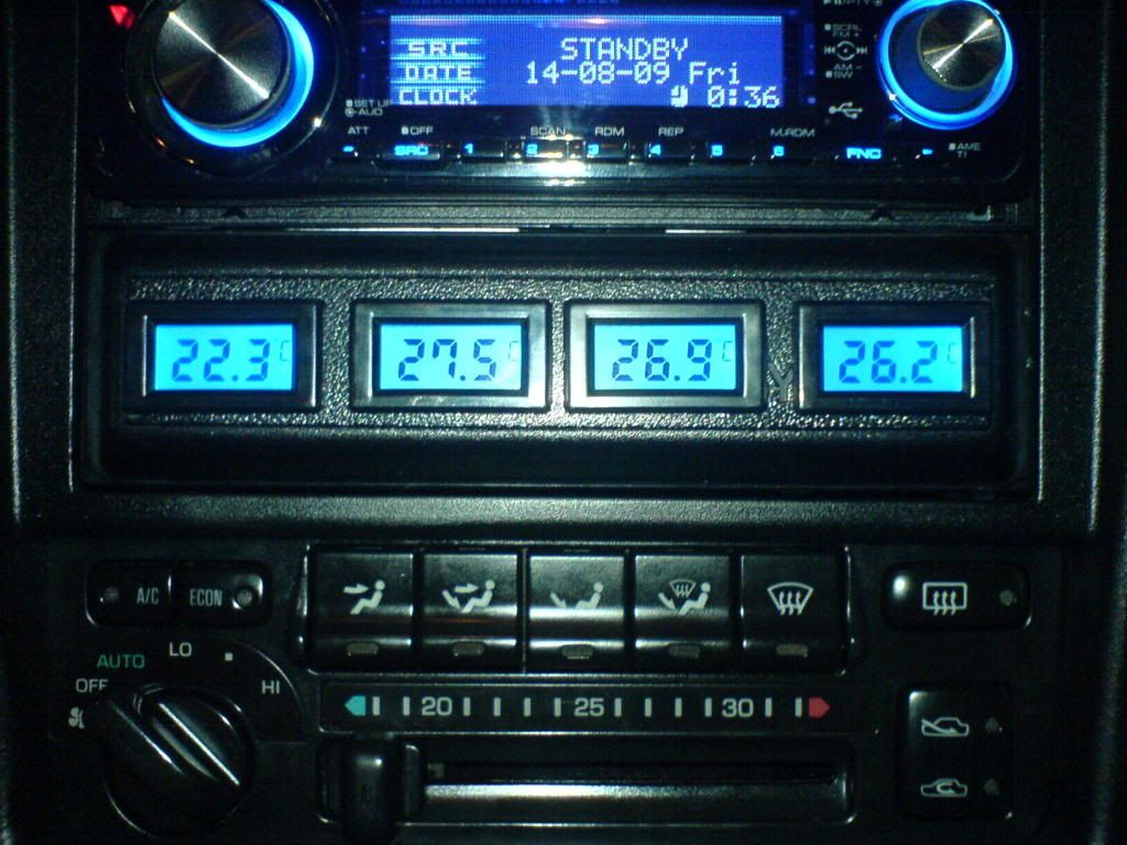

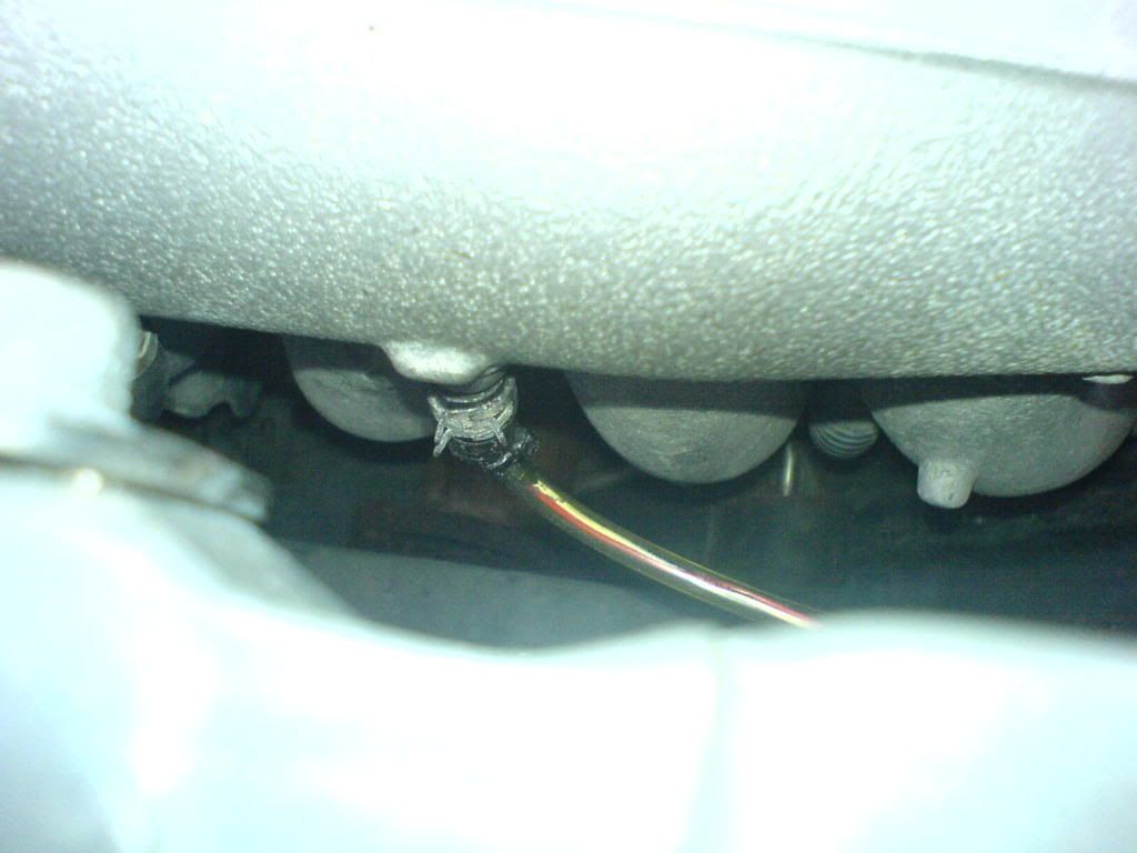

PostPosted: Mon Sep 21, 2009 11:27 am    Post subject: Reply with quote Reply with quote including images
I'm using an lcd digital display meant for monitoring temperatures inside of PC cases. The probe is in mounted in the inlet manifold using the blanked off pipe on the bottom of the inlet manifold.
Oh, and I've already heard all the jokes about back to the future and Darth Vader's bathroom before anyone else starts getting clever [Applause]

PostPosted: Mon Sep 21, 2009 11:35 am    Post subject: Reply with quote Reply with quote including images
very nice, ive just bought the same displays (2) and im installing them today... 1 for the CC coolant and one for the intake temp...

PostPosted: Mon Sep 21, 2009 11:44 am    Post subject: Reply with quote Reply with quote including images
Cheers [thumleft]
What displays did you go for? I ask because I had loads of problems with the gauges constantly tripping out due to electrical noise picked up by the sensor and it took me a long time to find some gauges that worked.
Where abouts are you mounting the displays?
Are you planning on going up that blanked off pipe for the inlet temp?

PostPosted: Mon Sep 21, 2009 12:21 pm    Post subject: Reply with quote Reply with quote including images
Moo wrote:
Cheers [thumleft]
they looked to be the same gauges that you have there, ive mounted the displays on the plastic panel that the gear gator clips to. (im running out of space for gauges!!)
Ive put the coolant temp sender in the CC level by drilling a hole through it, putting the sender through and sikaflex'd, and on the rev3 inlet manifold you should see a blanking plug on the very left towards the gearbox... ive drilled a hole through this, put the sender in and sikaflexed again
just waiting for the sikaflex to harden now but ill get some pics when its all done [thumleft]

PostPosted: Mon Sep 21, 2009 1:05 pm    Post subject: Reply with quote Reply with quote including images
Cool [thumleft] Let me know if you have trouble with the displays tripping out.

PostPosted: Mon Sep 21, 2009 1:13 pm    Post subject: Reply with quote Reply with quote including images
Moo wrote:
Cool [thumleft] Let me know if you have trouble with the diplays tripping out.
I plan on wrapping the wires from the senders onwards with silver foil, what you reckon? I think it should work as when I cut the wires on my Innovate LC-1 wideband loom, it was pre-wrapped with silver foil from the factory, I can only presume to keep any interference down... [Think] seems logical to me [Anxious]

PostPosted: Mon Sep 21, 2009 4:28 pm    Post subject: Reply with quote Reply with quote including images
TBH I don't think wrapping the wires will make any difference. I've seen posts on here from somebody that had troubles with his displays tripping out and he went to extreme lengths wrapping all the wires with some kind of heavy duty shielding he got from his work and that didn't make the slightest difference. At the end of the day you may wrap the wires but the tip of the temp sensor itself is the weak point and I think this is where the "noise" gets in. There's no harm in wrapping the wires but I'd be surprised if it helps. If your displays trip you're stuffed but I can point you to the ones that don't [Wink]
http://www.quietpc.com/gb-en-gbp/products/caseaccessories/kama-thermo
The mini display are the ones you see in my picture but i've also tried the larger ones mounted in the ashtray and they were fine as well [thumleft]
