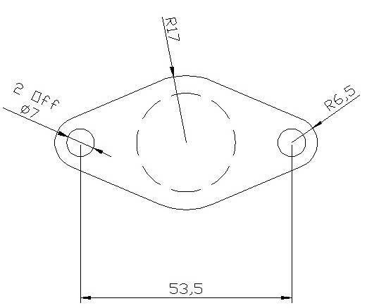

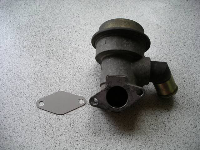

Marc,
There are a few ways of doing it. The way I did it was to make a blanking plate and sandwich it between the ABV and the pipe. Simple as that!

I have used Tom's diagram for my blanking plate and can confirm it is a good method to go with.

yep i used toms method as well. just how a mod should be, simple and it works.

It's the one above I've been offered by Alister :D
Just need to know where the ABV is to fit the plate.

The reason is Garrick, that equalising the pressure by swopping VSV lines around is not the best way to do it. For example Mark found by blanking his ABV off and removing it from teh equation entirely that he made more boost than he did with teh VSV lines equalised. There is potential for leakage when you swop the VSV lines around, there isn't when you simply blank off the ABV.

boost pressure is vented off above 8psi, so when you fit a big pulley you need to stop this because otherwise you'll vent all that extra boost generated to fresh air.
