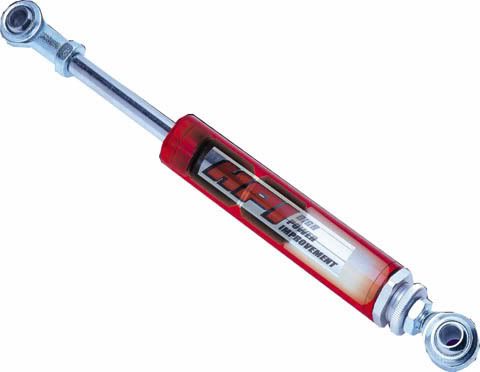

on the subject of vibration, there are similar units out there that are a damped unit rather than a solid bar like we are discussing here, for instance
the silk road engine torque damper
available from nengun
http://www.nengun.com/
and the HPI engine torque damper
available from japan parts
http://www.japanparts.com/db/partslist.php?dealer=2&car=31&middle=1&small=1
EDIT: heres another one
https://www.rhdjapan.com/shop/cart.php?m=product_detail&p=1279

PostPosted: Mon Dec 25, 2006 10:09 pm    Post subject: A1 Reply with quote Reply with quote including images
(Yep given all things equal and can come to a plan! )one of these guys will
just about complete the chasis suspension tuning and oh probably with
a cucso brake master cyliner brace too. [thumleft]
Silk road engine torque damper me finks... [Think] [Dancing]
Nice one. [Cool]
