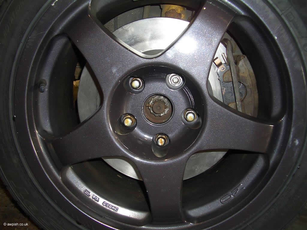

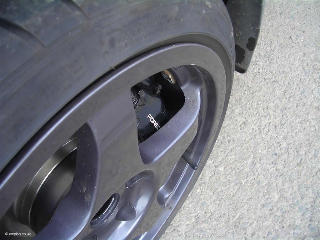

so my brakes were prety much fubar'd, the front calipers needed replacing as did the discs and the rear discs were in need of being replaced too. Did some sums and decided i hated the std brakes enough to pay some extra and fit something a little better (in my opinion :cyclops: )
So i bought a set of rear caliper re-locating brackets from Ant via his group buy and they came with all parts and fitted perfectly. So the rears are std calipers (cleaned up) and Mazda RX8 front 323mm discs however I chose not to fit the front kit as the calipers there were knackered. After chatting to various people and seeing some other setups I chose Porsche 996 front 4 pot monoblock calipers fitted over the Supra 325mm disc. Now I know the std mr2 brakes when working properly with race / endurance pads are the best thing in the world but if we all thought the same the world would be a little bit boring. Pedal feel is consistent, travel isn't excessive though I'm still bedding them in and tbh my original brakes were so pants the travel and feel of them was different on every press :shock:
For track day fans, the front setup per side is half a kilo heavier (alloy calipers) and the rears are 2.5kilo's heavier per side (same std kit but a bigger and heavier disc) Anyway some pics below, wheels are 8x17 ET 35 and rears 9x17 ET35. Rear clearance is fine as expected, the fronts do clear with plenty of space but it was heart in mouth til I'd done a test fit
close up of fronts
showing clearance of the calipers, wheel design here helped massively
close up of rear
Not to everyone's taste I know and some might say a waste of time effort and money but I like it and it's my car! :mrgreen:
